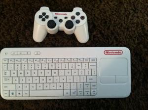

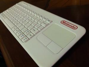

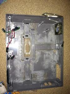

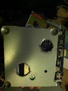

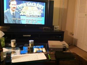

nespcbuild Posted March 10, 2014 Author Posted March 10, 2014 It's been a while since I updated this thread and a lot has happened since. I finished modding the backplate for the mobo but it wouldn't fit inside the NES case because the board was positioned too high and wouldn't clear the controller ports on the inside. Modding the backplate was the biggest PITA and it turned out to be a waste of time. Here's a pic of what could have been: I wound up just drilling some holes through the back of the NES case and mounting the MOBO with some stand-offs I got a nice Nintendo sticker from an ebay seller and used it on the wireless keyboard. I scrubbed off the Logitech logo with some rubbing alcohol and applied the Nintendo logo in it's place. The seller was also willing to print some out in a smaller size to fit on the Sony PS3 controllers that I'm using but they haven't arrived yet. I'll update with pics of the controllers once they're done. Here's the case with the T-shaped piece glued back in. I also added an intake fan to the back of the case. Since the back is not usually exposed, it seemed like the best place for it. The exhaust fan sits where the vents are on the top of the NES case. I'll upload some more pics here in a while once everything is complete. I also purchased a 1TB SSHD which I have yet to install. I also got a usb card that adds 4 USB2.0 internal headers and 2 USB ports all inside the NES case. I'll add pics of that later as well. I also modded in a secret door where the black peice sits above the contoller ports. When it's done, I'll be able to flip it up to reveal 2 USB ports on the front of the console. I've started working on my Hyperspin setup and currently have NES, Genesis, Master System, and SNES installed. both NES controller ports are working and I found a seemless solution for using my PS3 controllers wither with USB cables or wirelessly via BT. More details on that to come... I also got my reset button working (to reset emulators rather than restarting the computer) thanks to Corny @ Battlenerds (AKA ZacUSNYR). I asked him for some tips on writing a script in autoit that would perform the reset function and he was kind enough to write me a complete script that sends unique keyboard commands to reset emulators based on which emulator .exe is currently running. It works great! I'll add some more detail about all of this stuff when I have more time.

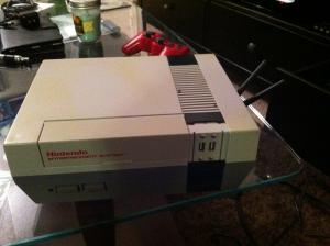

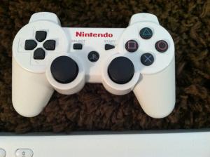

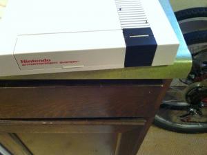

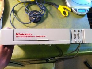

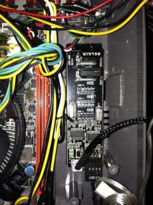

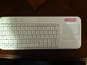

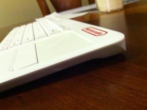

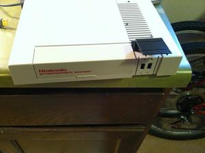

nespcbuild Posted March 17, 2014 Author Posted March 17, 2014 OK time for an update... I installed my new 1TB SSHD. It's pretty nice. Not as fast as booting form an SSD but definitely faster than booting form a normal HDD. No pics of that unfortunately. I installed my internal USB 2.0 expansion card. It adds a few internal USB 2,0 header pins and 2 internal USB ports which house the dongle for my wireless keyboard and a bluetooth dongle that I'm using for my PS3 controllers. Here's what it looks like: I also got my Nintendo logo stickers for the PS3 controllers. I still need to buy more controllers. I'm going to use all white ones to match the keyboard. I decided to do away with the oval around the "Nintendo" because it looked too crowded with the "start" and "select" all crammed in so close. Here are pics of the controller and the keyboard: I also started working on the hidden USB ports/hinged door for the front of the console. the hinge still needs to be painted and attached but you can get an idea of what it'll look like when it's done from these pics. To cut out the USB ports I screwed on the backplate that came with the ports for a guide, then I dremeled out the holes and then cleaned them up a bit with an exacto. Not perfect, but good enough for me. I still need to find some flat screws for the ports so that everything will be flush. Pics: Last, here are a couple of pics of the console after I put it back together. It still has a way to go but it's getting close. I also finished my AHK scripts for launching/killing the reset script and Xpadder when Hyperspin starts/stops. Everything is working perfectly XD Once the hinge for the USB door is done I'll start adding the other various controller ports inside the cartridge door. --Oh! I almost forgot: I picked up this badboy at the mall on Saturday
