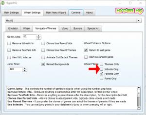

Tomkun Posted April 25, 2016 Posted April 25, 2016 I think he wants the bottom one "roms only". Unless I am misunderstanding, I think he is asking to only display wheels for games that he has roms for.

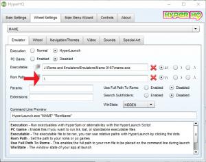

gigapig Posted April 25, 2016 Posted April 25, 2016 I think he wants the bottom one "roms only". Unless I am misunderstanding, I think he is asking to only display wheels for games that he has roms for. After a reread I think you're right. In that case you will need to add your Rom path as well. If HyperHQ crashes when you try to add the path, then you will need to add it manually.
badboo Posted April 25, 2016 Posted April 25, 2016 I think this is the setting you are looking for. Image 2.jpg Actually what works for me , to display only the wheels with the roms I have, in hyperHQ I click (or activate) "wheels only" and "roms only".
meancun Posted April 26, 2016 Author Posted April 26, 2016 Perfect guys, that's exactly what i was after. Only displaying games in the system's wheel within HS for roms that i have in the roms directory for that system. I should learn to be much more specific. I'll give that a crack and see how it all goes. Thanks so much again
meancun Posted April 26, 2016 Author Posted April 26, 2016 ok so ive placed 1 zipped rom file in to the rom directory for MAME on my computer - C:\Hperspin\Emulators\MAME 161\roms\ I've then tested it separately through MAME and it works fine Ive gone in to HyperHQ and selected Wheel Settings> MAME> Under the Emulator tab, ive added the rom path C:\Hperspin\Emulators\MAME 161\roms\ I've added the Extension - .zip (note, i also added "zip" without the . and still had the same result) Now under the Navigation/Themes tab, i've checked "Wheels only" and "Roms only" and both had the same effect. As agent47 mentioned, im just bouncing back to the main system wheel selection after selecting the MAME wheel. Ive also tried the following combinations: - Wheels only and Roms only - Wheels only, Parents only and Roms only - Roms only (worked, but showed the complete list of games from the default MAME database .xml, rather than only showing the one game i placed in the rom folder) Any suggestions lads? Essentially, when i select MAME wheel, i only want the next screen in HS to show the 1 game i have placed in the roms folder. Cheers
meancun Posted April 26, 2016 Author Posted April 26, 2016 That worked! I copied the rom path you had, rather than hyperspin> emulators> MAME> roms>, i changed it to Hyperspin> Roms> MAME Question now is, rather than having the wheel flooded After Burner II continuously, can it just be shown once with no scroll? Thanks so much
