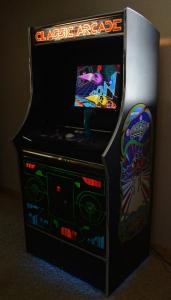

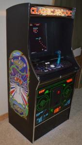

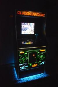

Markussage Posted January 30, 2014 Posted January 30, 2014 Greetings programs, First, I'd like to give a huge shout out to the entire arcade community - from HS and Mame, to BYOAC and everything in between, THANKS! Building my own cabinet has, in a way, completed something in my life. After thinking of the ideal shape cabinet for me, I thought the classic Galaga was great. Besides being one of my favorites, I love the classic shape. I am a huge fan Tron which is what was initially driving the whole project. Guess I always wanted both a Tron and Galaga cab. I have the x-arcade Tank Stick so the inner part of my cab had to be about 30". I decided to make the side panels more narrow (24") as it needed to fit through most doorways. Also, the back 2 wheels are stationary horizontal and the front 2 spin. That way I can move it sideways easily but it won't move front to back when my friends are jamming away on it. I have 3 florescent lights inside the cabinet, one behind the marquee, one in the whole center to light up my front board, and one underneath for the 'floating' look. I found 5" of translucent blue decal vinyl at a local printing shop. It stuck to the light bulb fine (florescent lights don't heat up.) I mounted it to the bottom and wired it up into the cab, presto! Helpful links: I mostly use Hyperspin as my FE. I also have and use Maximus Arcade. http://www.hyperspin-fe.com/content.php http://www.maximus-arcade.com/ I found a carbon fiber vinyl decal on Ebay, usually used for covering car parts. Worked great to cover the sidewalls and inside shelf. It was highly adhesive and cut down very easily. I ordered a 5' by 7' sheet and had plenty to work with. $30. Here's an example: http://www.ebay.com/itm/1FT-x-5FT-4D-Professional-Grade-Carbon-Fiber-Vinyl-Wrap-Air-Realease-Bubble-Free-/231066219352?pt=Motors_Car_Truck_Parts_Accessories&hash=item35cc9eb358&vxp=mtr I got the Galaga side art on Ebay as well (or just search Galaga Side Art,) $35 per side: http://www.ebay.com/itm/331089241799?ssPageName=STRK:MEWNX:IT&_trksid=p3984.m1439.l2649 I got a swivel TV/monitor mount from Walmart, here: http://www.walmart.com/ip/Ready-Set-Mount-CC-R25B-Flat-Panel-TV-Mount-13-to-37-Black/11018955 This mount was perfect. Now, I can very easily rotate the monitor (19"Dell) for the classics. I was able to Shell Hyperspin with this helpful guide: http://www.hyperspin-fe.com/forum/showthread.php?14319-HyperSpin-Shelled-on-Windows-7-Solved-and-Working! I was nervous about it but it worked flawlessly. I also shutdown upon exiting HS so the Windows environment is pretty much completely hidden. Many parts, including the retro Tron joystick, spinner, and more came from GroovyGameGear.com: http://groovygamegear.com/webstore/index.php?main_page=product_info&cPath=73&products_id=335 The very helpful guide for powering on your pc with arcade button is here: http://coolexpletive.blogspot.com/2012/04/how-to-replace-your-pcs-power-button.html I have my button slightly hidden so guests don't accidentally hit it. When the system is on, one push of the button will force shut down. Marquee came from GameOnGrafix.com. Scott is great! http://www.gameongrafix.com/products/generic-marquee-dot-techno-1 Every build is unique to its builder and that's one reason arcade gaming is so much fun on a variety of levels, from building to actually getting to enjoy your project. Everything on this cab was done with lots of thought and effort. I may install a bezel at some point if I can figure out how to still allow the monitor to spin. Otherwise, here it is and thanks for looking... Game on!! End of line.

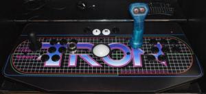

HazzardActual Posted January 30, 2014 Posted January 30, 2014 looks awesome man! is that a tank stick your using for the control panel? I was under the impression that there wasnt much room for adding stuff into those.

Polemicist Posted January 30, 2014 Posted January 30, 2014 Simple clean and like the lights around the base as well. Nice job. And thanks for sharing the links of things you used etc. very helpful to know.

Markussage Posted January 30, 2014 Author Posted January 30, 2014 HazzardActual said: looks awesome man! is that a tank stick your using for the control panel? I was under the impression that there wasnt much room for adding stuff into those. I like the xarcade for a few reasons. I can easily take it off the cab, customize it, etc. It came ready to go out of the box. Their cust support is awesome, etc..... I added a spinner, classic Tron flightstick, and Tron decal. Also, the 2 black buttons on either side of the P1/P2 buttons both stabilize the vertical movement of the mouse, like for Golden Tee Golf. I thought it would be nice to have them on the CP. I love my micro keyboard I scored on Ebay! Works well to keep it right up front. Here is a closer look.

sgeist28 Posted August 17, 2018 Posted August 17, 2018 How did you get the trigger button to work with the Tron joystick? I have an X-Arcade tankstick too and would like to get the Tron joystick but i didnt think there was a way to get the trigger button to work.
