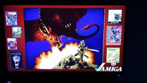

potts43 Posted May 24, 2016 Posted May 24, 2016 I have bezels for it and they work fine although Sweetfx looks slighty better without the bezel (less colour banding.) Have you checked the filter options in WinUAE under ""Filter"? I have mine set to automatic scaling. Tried that but the emulator just won't resize to fit the bezel. Tried changing the module settings but nothing seems to work. Strangely enough I have 5 bezels in the folder but the global next bezel key doesn't do anything. They change in other emulators which all use the next bezel global key. I'm getting so frustrated with everything breaking when it was working. Does your setup work as expected?
gigapig Posted May 25, 2016 Posted May 25, 2016 Tried that but the emulator just won't resize to fit the bezel. Tried changing the module settings but nothing seems to work. Strangely enough I have 5 bezels in the folder but the global next bezel key doesn't do anything. They change in other emulators which all use the next bezel global key. I'm getting so frustrated with everything breaking when it was working. Does your setup work as expected? My bezels are working but the bezel change is not like you mention. If it's not already discussed on the RL site then we may have create a thread.
potts43 Posted May 25, 2016 Posted May 25, 2016 My bezels are working but the bezel change is not like you mention. If it's not already discussed on the RL site then we may have create a thread. 2016-05-25 20.05.32.jpg Gig, Thanks for your help. Been driving me nuts! I wonder why your bezels are working! Can I grab your winuae folder to rule it out?
gigapig Posted May 25, 2016 Posted May 25, 2016 Gig, Thanks for your help. Been driving me nuts! I wonder why your bezels are working! Can I grab your winuae folder to rule it out? I'll pm you. I have 4 bezels and one out of the four does not work but the ini files are almost the same. Weird
