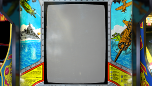

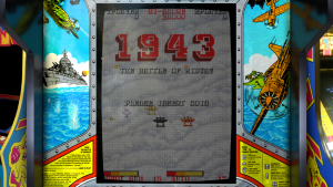

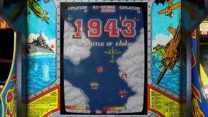

phulshof Posted August 22, 2016 Posted August 22, 2016 Did a quick test on 1943 for MAME .lay; seems it works just fine.
phulshof Posted August 22, 2016 Posted August 22, 2016 Did some more quick tests; looks like half the cfg files contain incorrect information. There may be some manual work involved here after all. I'll do the conversion to MAME first, and generate the RL ini files once I've figured out the correct MAME settings.
