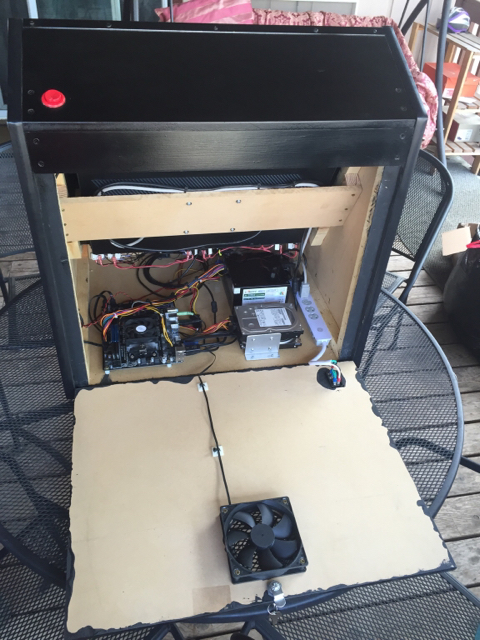

pasappie1978 Posted January 16, 2017 Posted January 16, 2017 sorry for the late reaction i used a sort of monitor stand, so i can change the monitor look, this is easy when you sitting in front of your bartop to program rocketlauncher etc.
