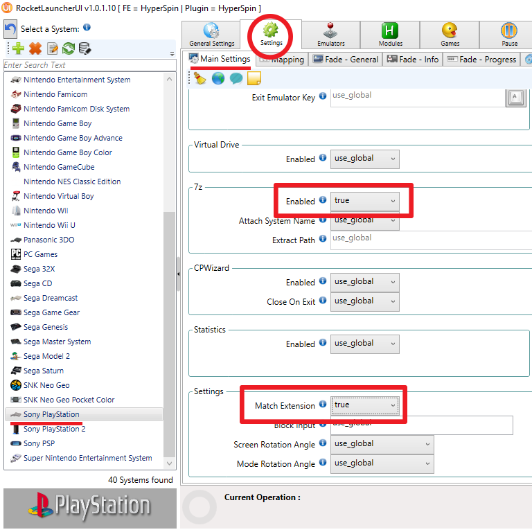

Do you have the games zipped or compressed in any way? If so the file name inside the .zip has to match the xml also.
As for the Playstation roms, same deal, files in .zip have to match the xml and also open up the .cue file with notepad and make sure it's pointing to the correctly named .bin/.iso.
Technically, the .bin/.iso doesn't need to be renamed as long as the .cue is renamed and is pointing to the correct file, but it makes it neater and saves u headaches in the long run
It looks like others have gotten bin and cue files to work with epsxe and RL and apparently I will need to figure it out, too.  The only torrent I could find with a backup of all my games (455TB - 1500+ Games) is bin/cue and will take me 2+ weeks to download on my slow DSL connection.

First for Playstation,  do you have the BIOS properly set up and renamed properly?
For N64, if you are certain all the rom extensions are listed in rocketlauncher, try copy/paste the name directly from the xml, I'm not sure why they wouldn't be showing up if it's named correctly and the extensions are listed in rocketlauncher

As this is dragging out I would suggest posting your RL log. And if you already did not know, "Always read the module notes" in case there is something you missed.
I'm so sorry but I don't know exactly what you're asking.  What do I do, under what configuration, and where do I find the log?  Does the program need to be in a certain state before generating the log and how do I go about that?
I don't know if this is what you're looking for or not, but I exited RL, went back into RL to start a fresh log (if it works that way), and tried to launch a bin file.  It seemed to load with no errors but instead of bringing up the game it just brought up a white screen that says, "Please Set CD-ROM" at the bottom.  I'm using Xebra for this test.  If I go to Xebra directly, outside of RL, and click, "Load ISO" then select the bin, it loads the game properly.

You need to enable 7z so Rocketlauncher will extract the cue/bin/iso before sending it to the emulator, this will avoid problems with emulators that don't support 7z (most of them).
Open RocketlauncherUI, select Sony Playstation, in settings, select the Main settings tab, set 7z enabled to true, and Match extensions to true to avoid problems with names inside archives. Picture:
Thank you SO MUCH for taking the time out of your day to help me and to make that picture!
Now I finally have AUDIO and the game loads, but instead of video, I just get a white window that takes up part of the screen and is blank other than at the top it says file, menu, help, etc, but nothing is clickable.  I hear the game running in the background, though, so we have some success!!!!
