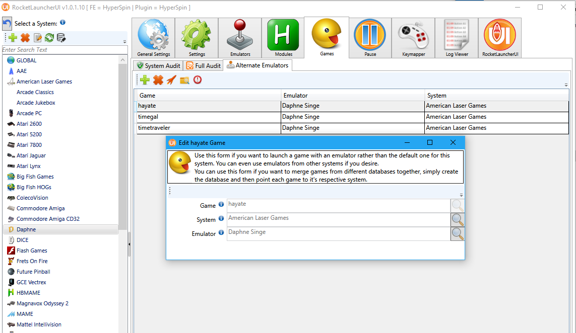

wesfranks Posted February 27, 2017 Posted February 27, 2017 You have a choice between two "Alternate Emulators" to run these Singe games in your Daphne system wheel. If you use the Singe module as the "Alternate Emulator", the rom folder path points to your Singe framefiles (txt) which should have the above three games' framefiles, as well as framefiles for ALG and ActionMax games, if you have those installed. The framefile for that game specifies the folder that contains the video/audio files to run as well as the game script (singe) file which controls what scene in the video is displayed. This method bypasses bat files by using information you enter to set up the Singe module/system to structure the command line and start the game with proper settings. Since the Singe module sets up the command line, it doesn't use the game bat files. If you choose to use the bat file method to launch those three games as the "Alternate Emulator", you have to use the PCLauncher module. If you look at the module, it already has ALG listed in the MSystem header for this eventuality. Each game entry would have to point to its own bat file. If the game loads successfully and then errors back to RocketLauncher after a few seconds, you may also have to set a fade title for each game.
wesfranks Posted February 27, 2017 Posted February 27, 2017 This might help..... Three games set up under Daphne wheel using ALG as the alternate system loading with the Singe Module (first method above). With the second method (not pictured here), the only thing that should change is PCLauncher as the emulator.
ci2own Posted February 27, 2017 Author Posted February 27, 2017 6 hours ago, wesfranks said: This might help..... Three games set up under Daphne wheel using ALG as the alternate system loading with the Singe Module (first method above). With the second method (not pictured here), the only thing that should change is PCLauncher as the emulator. Do i need to create a .txt fremefile to load those 3 games then? Daphne Singe doesn't use .txt extensions to load games. In your setup, what extensions are used to load this games?

Metalzoic Posted February 27, 2017 Posted February 27, 2017 Sorry, I was wrong and confused the issue. I don't use the Bat files to launch the game at all. I launch them just like Wesfranks said above. The rompath points straight to the Singe files in the Singe>Hayate or Singe>timegal folders. So my LaserDisc system points towards both rompaths, all games are in the single database, and you set the Singe games to launch with the alternate Singe emulator under the games tab in RocketLauncher.
ci2own Posted February 27, 2017 Author Posted February 27, 2017 16 minutes ago, Metalzoic said: Sorry, I was wrong and confused the issue. I don't use the Bat files to launch the game at all. I launch them just like Wesfranks said above. The rompath points straight to the Singe files in the Singe>Hayate or Singe>timegal folders Great! That worked! Thanks so much for helping me to solve the problem!
