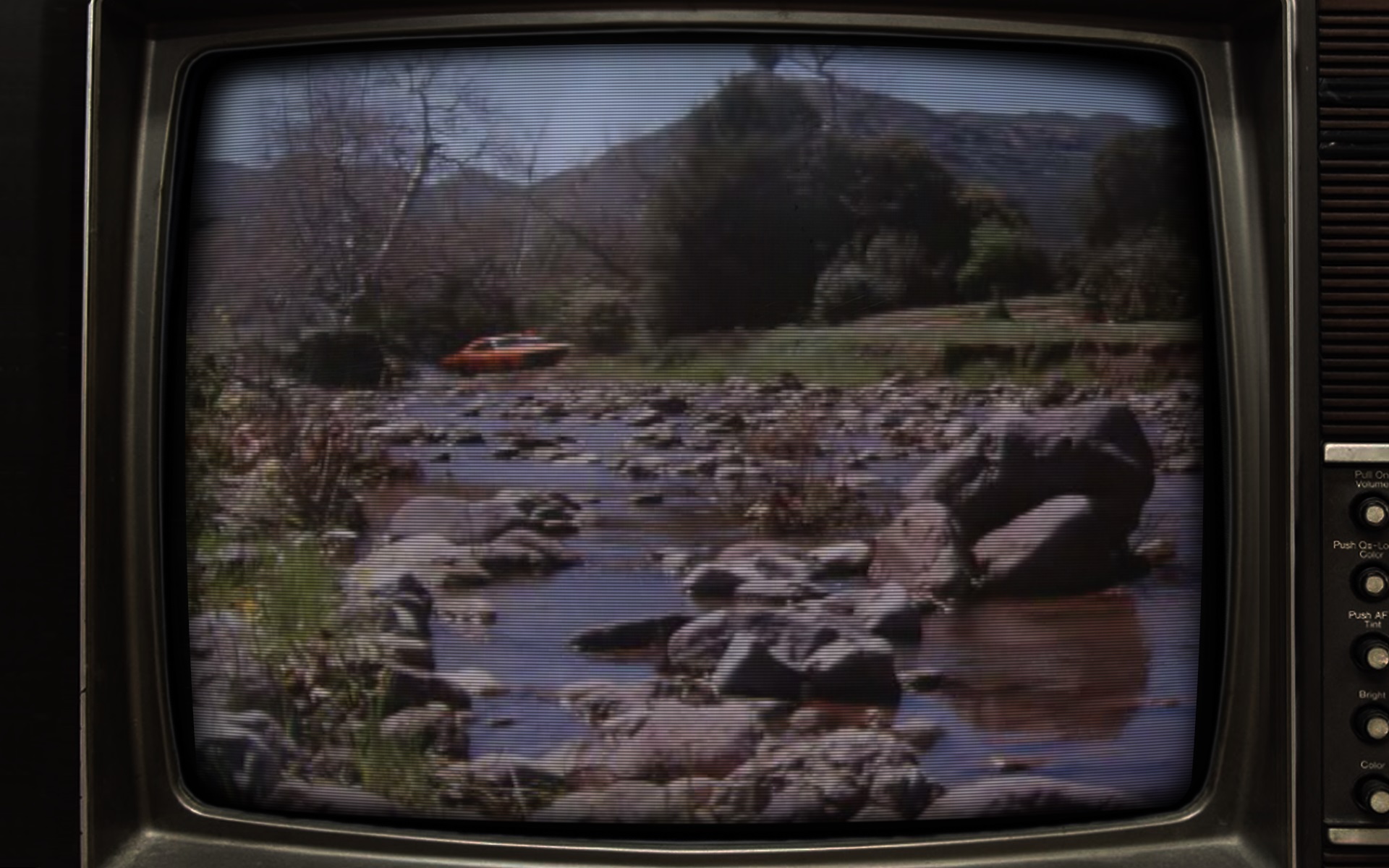

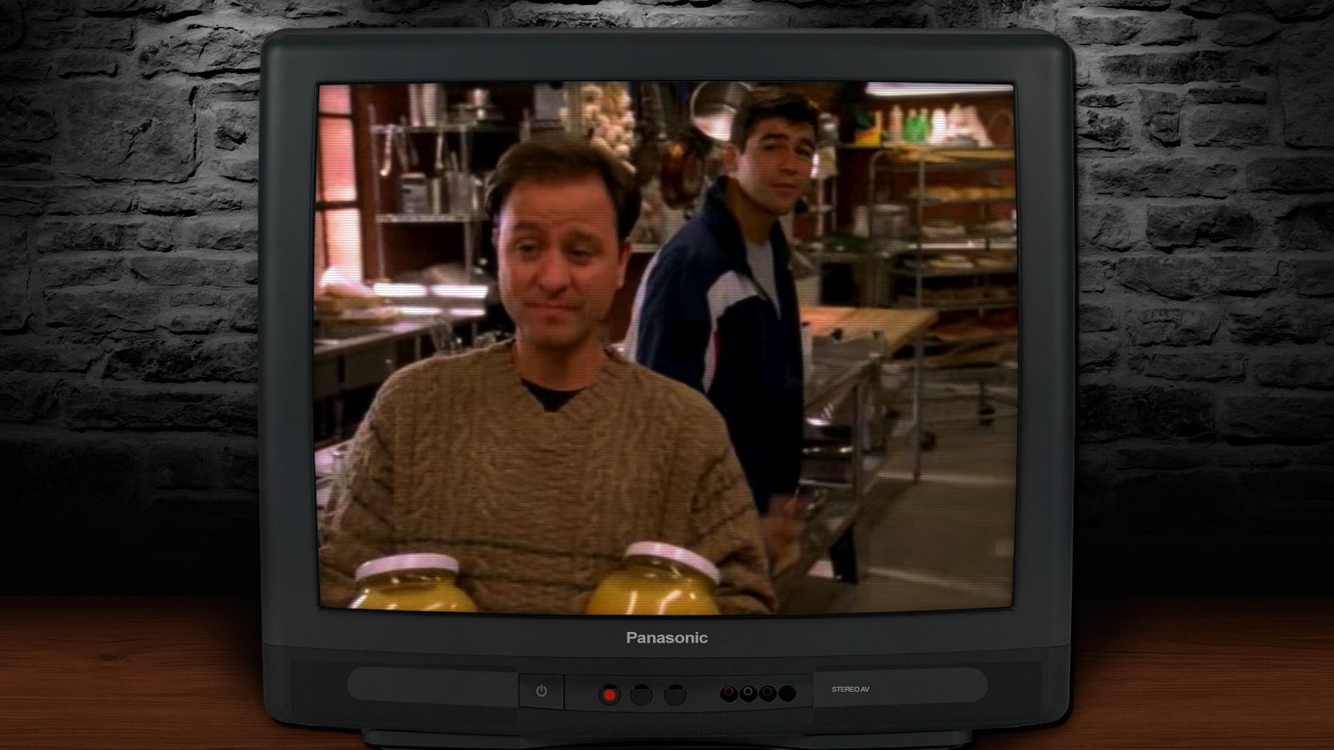

There in Libretro forums I wanted to know more about video playback in Retroarch, I remember when first reading about it, Retroarch was meant to be a multi purpose software, emulation is part of it, but it has general media support, Exodus tested it, and suddenly we noticed that Retroarch plays videos like any other player. When I first loaded a video, yesterday it loaded this, as Retroarch is configured to use a TV border and a crt shader:

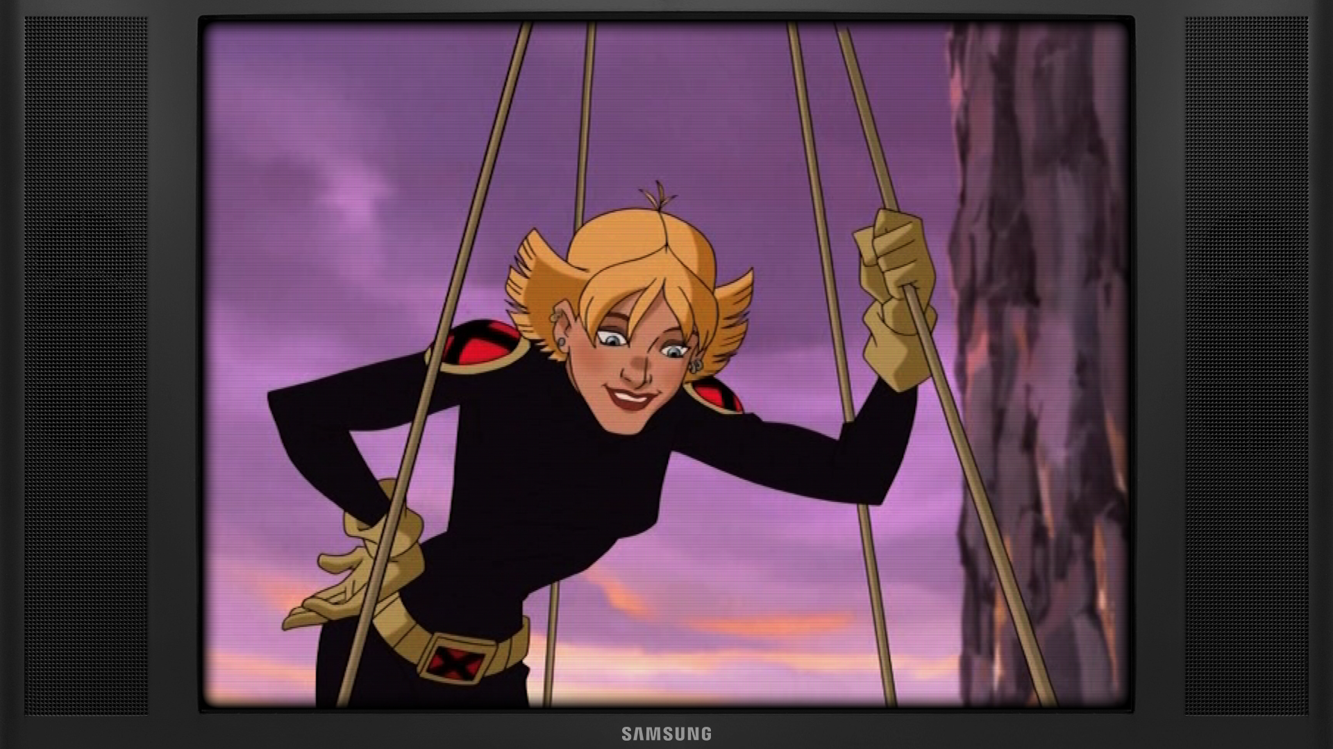

Some other screenshots:

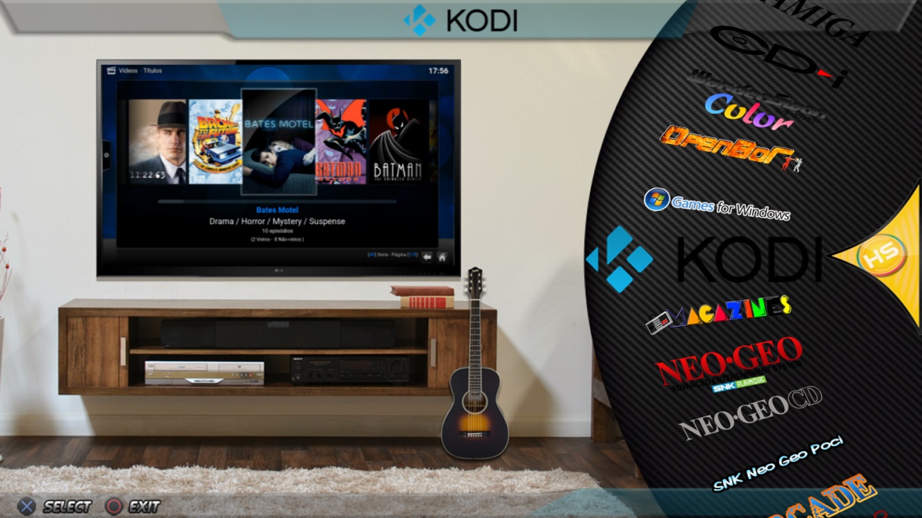

Installing Kodi and adding it to Hyperspin
This tutorial will show you how to add Kodi in Hyperspin focusing on using Retroarch as a main player to play 4:3 content in modern TVs, making even low quality old videos look great and authentic.

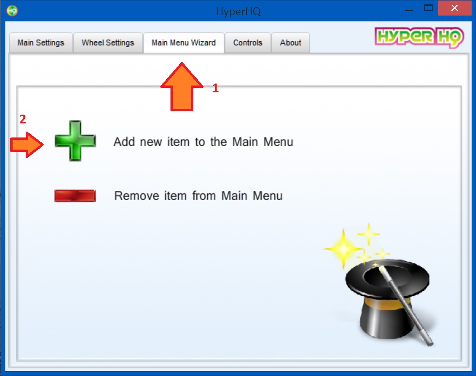

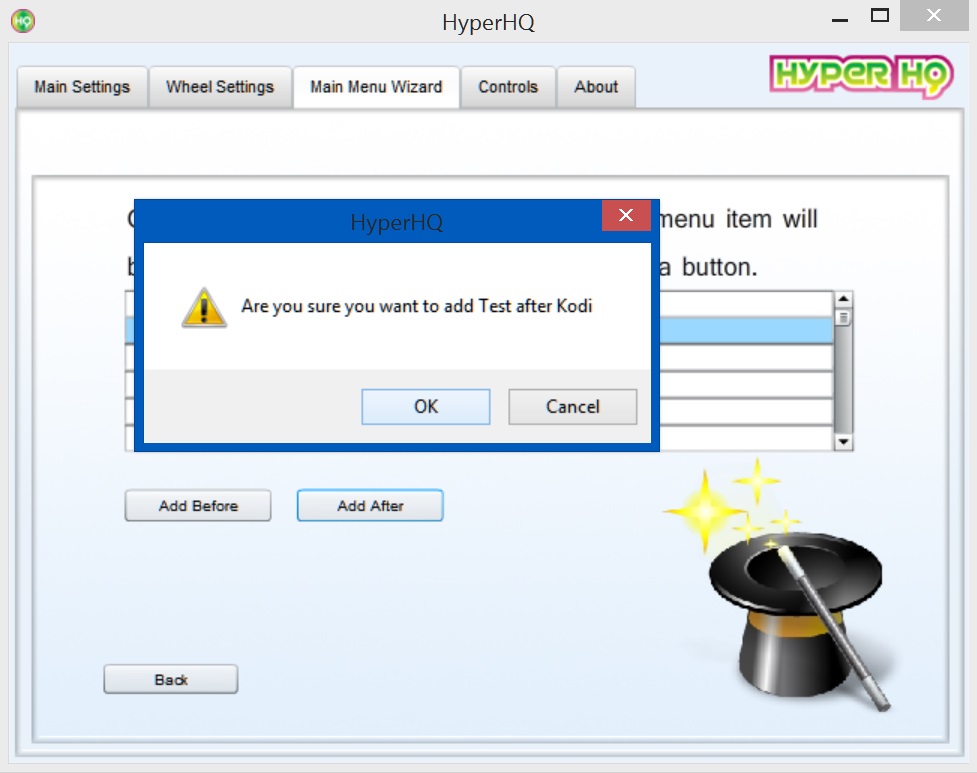

Assuming you have Kodi installed in its default directory (not mandatory, but simpler), open HyperHQ, click in Main Menu Wizard tab and then in the plus sign:

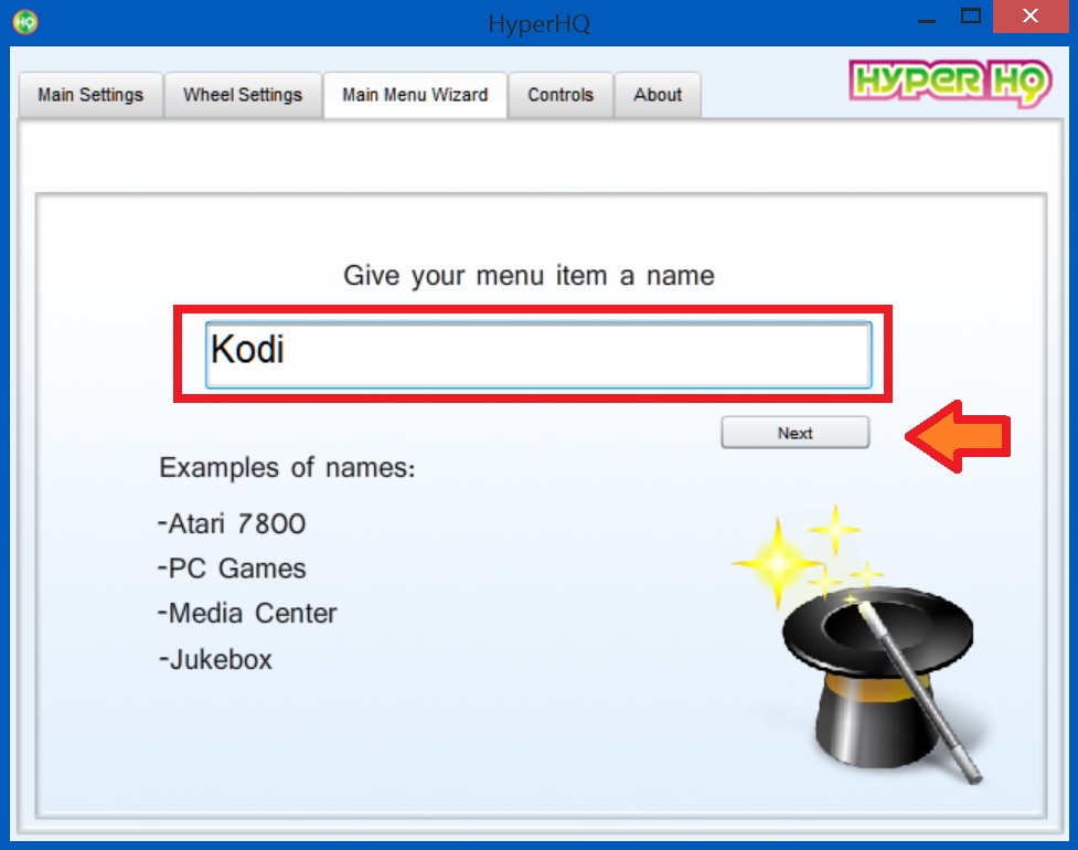

Name it Kodi and press Next:

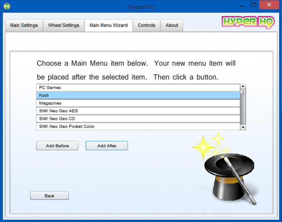

Choose whether you want it before or after a specific system.

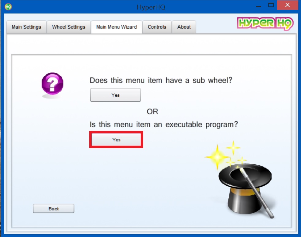

This step is really important, choose "Is this menu item an executable program?", Yes:
Obs.: If the first option is selected, Hyperspin will always try to find a xml for this system, and it won't work.
Just confirm the dialog box and continue:

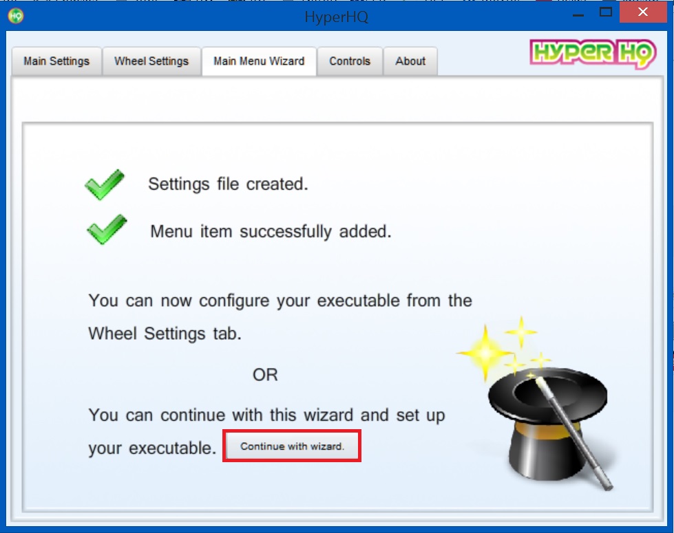

This window will show you a resume of what was created, and will prompt you to Continue with Wizard, so we can find the Kodi.exe file:

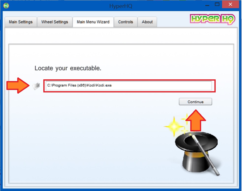

This is the default Kodi.exe path:

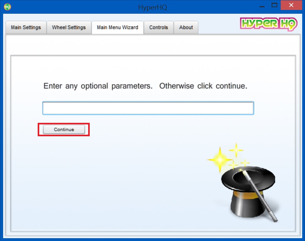

No need to fill anything here, just move on:

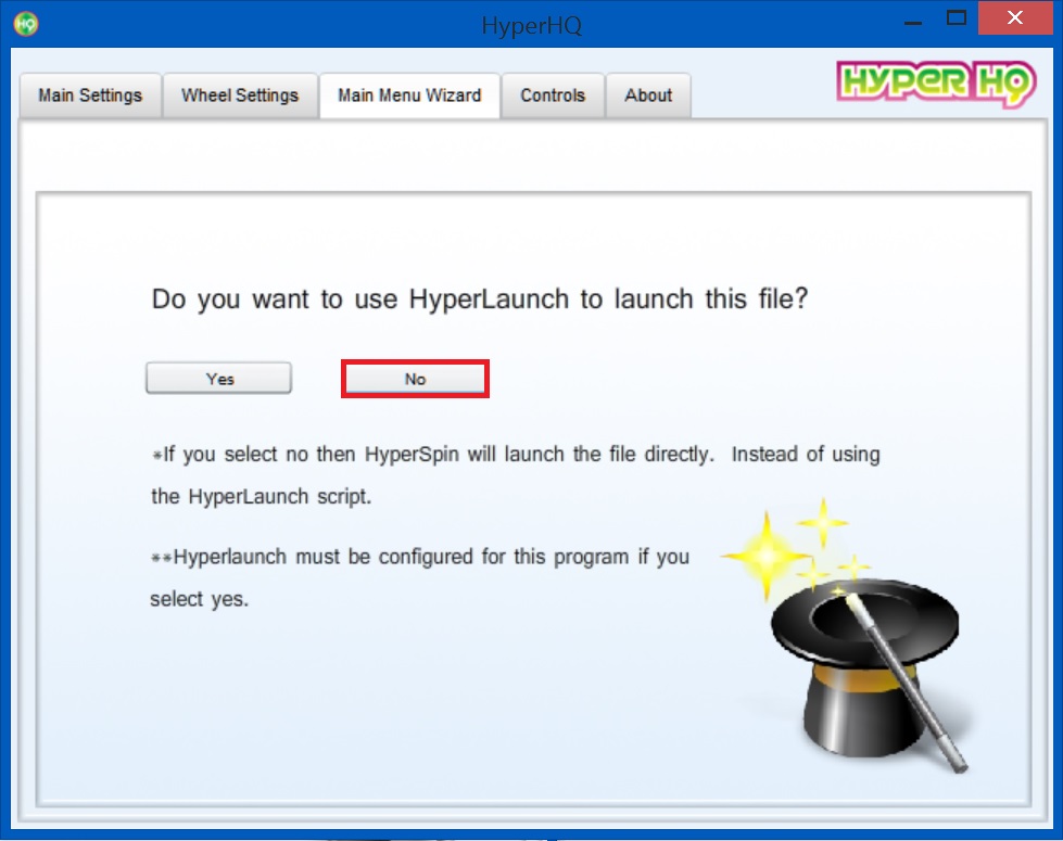

We won't need any Hyperlaunch (Actually Rocket Launcher) intervention using Kodi inside Hyperspin, just say No:

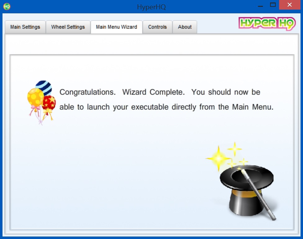

Kodi added with success.

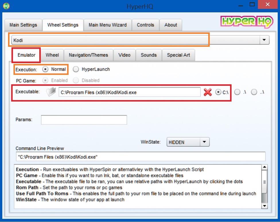

Now, still in HyperHQ click on Wheel Settings, choose Kodi and make sure you have these settings:
Obs.: WinState is Hidden, so Kodi will only show up when fully loaded, otherwise, a cmd window may appear above Hyperspin.
We have now Kodi inside Hyperspin, make sure you put a main theme named Kodi under Hyperspin\Media\Main Menu\Themes\Kodi.zip, and possibly a video preview.

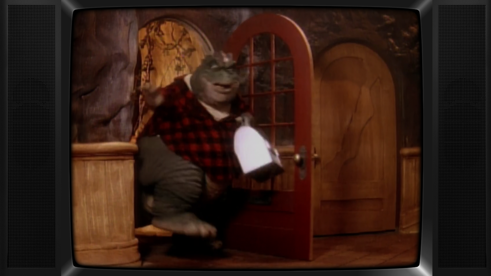

* Watch SD content with a nice shader, simulating a CRT screen, avoiding pixelated low quality video.
* Fill in black lateral bars with a nice TV frame/border, making use of all your TV/monitor screen, while not stretching the videos, losing its aspect.

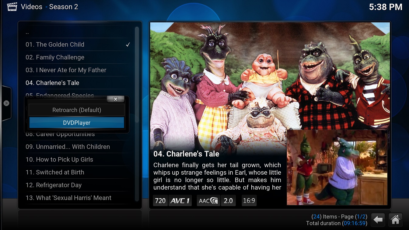

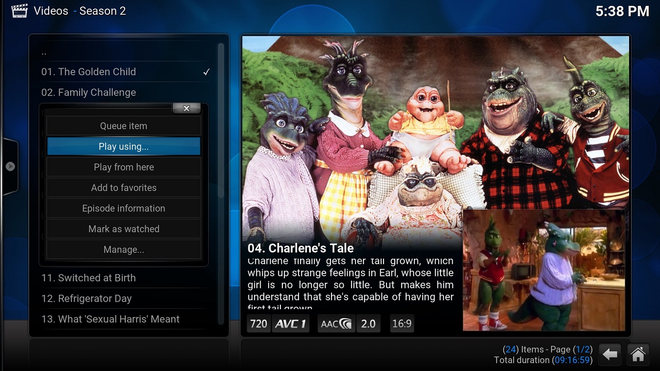

Assuming everything is in place, once in Kodi, if you try playing any AVI or MP4 file (set to default above), it should load the video directly, in case the video has a different format, that wasn't set in the playercorefactory.xml, the default Kodi video player will be used, but still, clicking with the mouse right button in the video you want to play, you have a new option, "Play Using":
Then you can choose whatever player you have added or the default Kodi player, in this case, as the video is an AVI file, Retroarch becomes the default player:

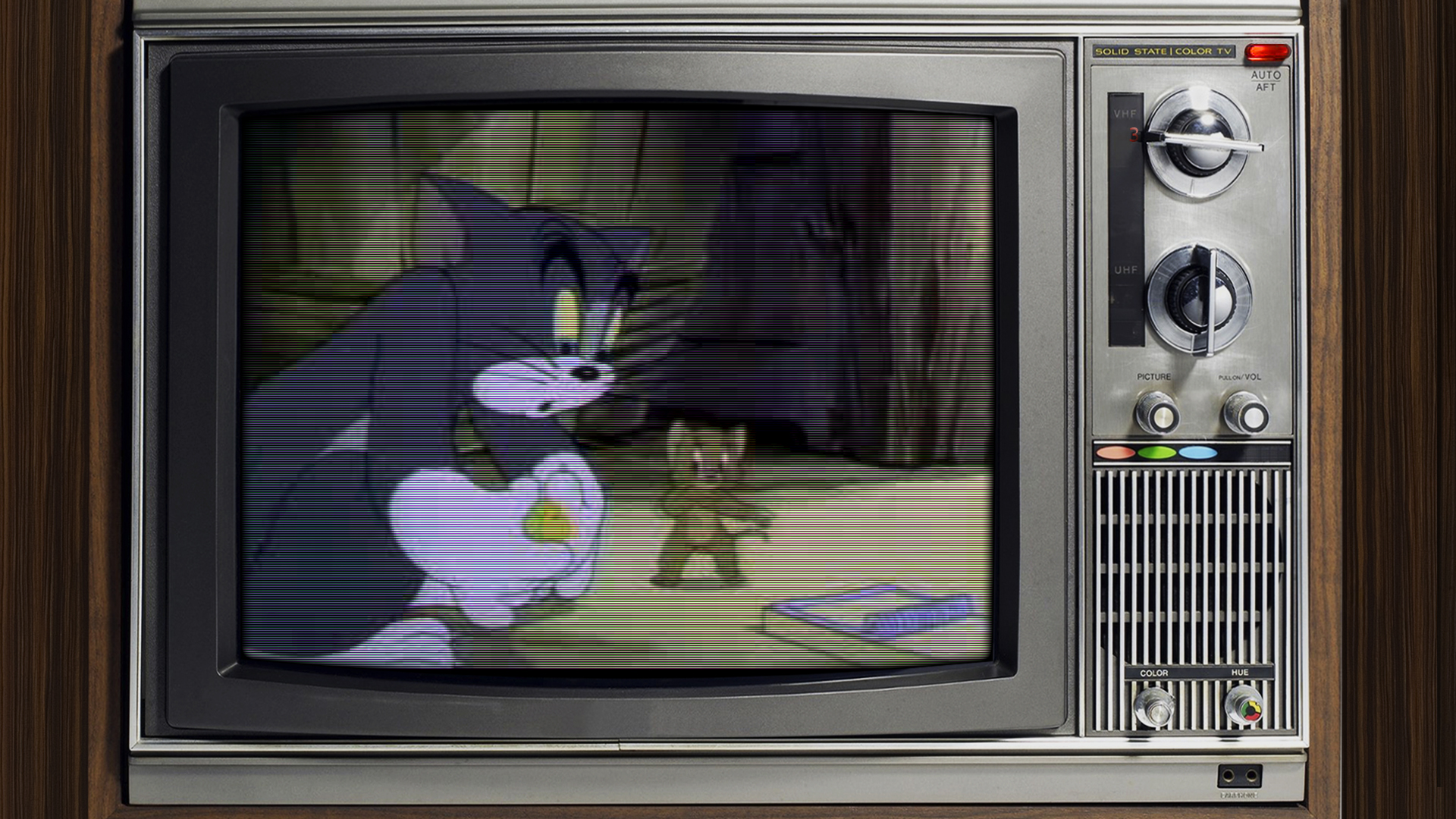

Some TV border samples:
Some Shaders can simulate even bad signal transmissions.
You can basically use any TV with any background, you can rebuild your old room with your old TV if you want.
