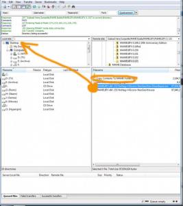

sreisig1 Posted April 14, 2014 Author Posted April 14, 2014 I just tried to rightclick the file and hit download, but the download button is greyed out?
gigapig Posted April 14, 2014 Posted April 14, 2014 Just pick it up and drag it over to your desktop or to where I have marked. Also grab the zip file I have put that beautiful orange ring around.
sreisig1 Posted April 14, 2014 Author Posted April 14, 2014 Thanks Boss got it downloaded. Now what? hah

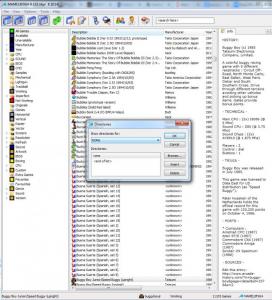

gigapig Posted April 14, 2014 Posted April 14, 2014 Thanks Boss got it downloaded. Now what? hah Which one did you download, the one I marked? What to do next?? well That's up to you, whether you want to start afresh or overwrite. I would start anew and keep your old in case you need some files copied across. So you can create a new Mame folder put what you have downloaded into it (extracted of course) then run the exe. If you haven't moved your Roms you will need to point to them. Click options>Directories and point to your Rom path. Once you click OK, then your Roms will be audited. You can if run a game and start the Hyperspin set up. If your new to that process, watch my video guide or read some of the tutorials. Find them in my Signature. http://www.hyperspin-fe.com/forum/showthread.php?29481-How-to-install-HyperSpin http://www.hyperspin-fe.com/forum/entry.php?122-My-Guides If you want hi scores to work, there is a "dats" folder included with that zip you downloaded. You will need to put your hiscore.dat and history.dat in that folder.
