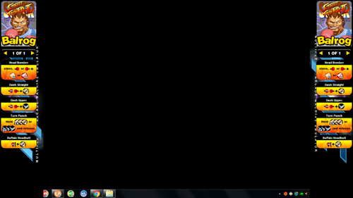

KRIS85 Posted November 29, 2019 Posted November 29, 2019 Hello, I have a question, I found a 16: 9 bezel + instruction card for mame but I have a problem after starting the game does not start on full screen you can see the taskbar as in the photo below how to fix it ? I have a 24 inch 1080p widscreen monitor.
ninja2bceen Posted November 30, 2019 Posted November 30, 2019 Oh I see what you mean, change the bezel background to a more pattern or solid color. Instruction cards sit on top of bezelsSent from my iPhone using Tapatalk Advance the cause to 100%. http://hyperbase.hyperspin-fe.com/ Planet Geekdom, Subscribe for Tutorials! https://www.youtube.com/channel/UCdcby-s2GwriaOHGmVC2vGA?sub_confirmation=1&app=desktop
