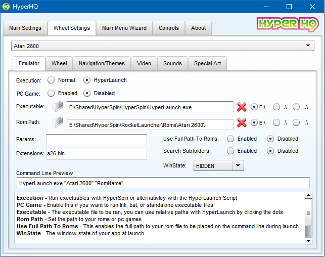

avidsonicfan1991 Posted August 5, 2017 Author Posted August 5, 2017 I changed a lot since, but now I have gotten all the way back to the very first problem!!! This is what my HyperHQ setup looks like: But whenever I click on ANY title, nothing happens! Here is the log (I did click on the game twice): Quote 01:52:56 PM | HyperSpin Started 01:52:56 PM | Going FullScreen 01:52:56 PM | Checking for updates 01:52:56 PM | Update Check Complete 01:52:56 PM | Startup program unavailable 01:52:56 PM | Menu Mode is multi 01:52:56 PM | Loading Main Menu.xml 01:52:56 PM | Main Menu.xml successfully loaded 01:52:57 PM | Main Menu wheel loaded successfully 01:52:57 PM | Loading Atari 2600.xml 01:52:57 PM | Main Menu.xml successfully loaded 01:52:58 PM | Atari 2600 wheel loaded successfully 01:53:01 PM | Atari 2600 wheel loaded successfully 01:53:09 PM | Launching Game 01:53:09 PM | Using HyperLaunch 01:53:09 PM | Getting Launcher path 01:53:09 PM | Can't find HyperLaunch, defaulting to root HyperLaunch.exe 01:53:09 PM | Launcher located at E:\Shared\HyperSpin\HyperSpin\HyperLaunch.exe 01:53:09 PM | Running Launcher 01:53:09 PM | Launcher Command Line is: E:\Shared\HyperSpin\HyperSpin\HyperLaunch.exe "Atari 2600" "Asteroids (USA)" 01:53:13 PM | Launching Game 01:53:13 PM | Using HyperLaunch 01:53:13 PM | Getting Launcher path 01:53:13 PM | Can't find HyperLaunch, defaulting to root HyperLaunch.exe 01:53:13 PM | Launcher located at E:\Shared\HyperSpin\HyperSpin\HyperLaunch.exe 01:53:13 PM | Running Launcher 01:53:13 PM | Launcher Command Line is: E:\Shared\HyperSpin\HyperSpin\HyperLaunch.exe "Atari 2600" "Asteroids (USA)" 01:53:18 PM | Loading Main Menu.xml 01:53:18 PM | Main Menu.xml successfully loaded 01:53:18 PM | Main Menu wheel loaded successfully 01:53:19 PM | Exit program unavailable 01:53:19 PM | Quiting Hyperspin 01:53:19 PM | Bye! If you're suggesting a less painful alternative to HyperSpin, all I need is a frontend with an EXIT HOTKEY. Every time I want to exit a game, I don't want to get up from my chair, grab my mouse, and navigate to a close button just to exit the emulator! (*cough* EmulationStation) Attract-Mode has that sort of thing, but I don't know how to split romlists that share the same emulator!
avidsonicfan1991 Posted August 5, 2017 Author Posted August 5, 2017 2 minutes ago, agent47 said: As I suspected, you don't have HS and RL connected properly. Your log shows the "Hyperlaunch_Path" in the HyperSpin/Settings/Settings.ini file is wrong so it's falling back to using HyperLaunch so fix that path. If you're using RL you shouldn't have anything set for the executable in HyperHQ and you would only need the rompath and extensions set if you're using the Roms Only filter. I removed the executable section in HyperHQ, but now.......... Quote 02:03:18 PM | HyperSpin Started 02:03:18 PM | Going FullScreen 02:03:18 PM | Checking for updates 02:03:18 PM | Update Check Complete 02:03:18 PM | Startup program unavailable 02:03:18 PM | Menu Mode is multi 02:03:18 PM | Loading Main Menu.xml 02:03:18 PM | Main Menu.xml successfully loaded 02:03:19 PM | Main Menu wheel loaded successfully 02:03:21 PM | Loading Atari 2600.xml 02:03:21 PM | Main Menu.xml successfully loaded 02:03:21 PM | Atari 2600 wheel loaded successfully 02:03:24 PM | Atari 2600 wheel loaded successfully 02:03:28 PM | Launching Game 02:03:28 PM | Using HyperLaunch 02:03:28 PM | Getting Launcher path 02:03:28 PM | Can't find HyperLaunch, defaulting to root HyperLaunch.exe 02:03:28 PM | Launcher located at E:\Shared\HyperSpin\HyperSpin\HyperLaunch.exe 02:03:28 PM | Running Launcher 02:03:28 PM | Launcher Command Line is: E:\Shared\HyperSpin\HyperSpin\HyperLaunch.exe "Atari 2600" "Asteroids (USA)" 02:03:32 PM | Loading Main Menu.xml 02:03:32 PM | Main Menu.xml successfully loaded 02:03:32 PM | Main Menu wheel loaded successfully 02:03:33 PM | Exit program unavailable 02:03:33 PM | Quiting Hyperspin 02:03:33 PM | Bye!
avidsonicfan1991 Posted August 5, 2017 Author Posted August 5, 2017 I changed the Hyperlaunch_Path in Settings.ini to the HyperSpin folder where the HyperLaunch exe should be, but now...... same damn thing!
avidsonicfan1991 Posted August 5, 2017 Author Posted August 5, 2017 I just did just that, but......................................... Quote 02:17:37 PM | HyperSpin Started 02:17:37 PM | Going FullScreen 02:17:37 PM | Checking for updates 02:17:37 PM | Update Check Complete 02:17:37 PM | Startup program unavailable 02:17:38 PM | Menu Mode is multi 02:17:38 PM | Loading Main Menu.xml 02:17:38 PM | Main Menu.xml successfully loaded 02:17:38 PM | Main Menu wheel loaded successfully 02:17:40 PM | Loading Atari 2600.xml 02:17:40 PM | Main Menu.xml successfully loaded 02:17:40 PM | Atari 2600 wheel loaded successfully 02:17:41 PM | Atari 2600 wheel loaded successfully 02:17:42 PM | Atari 2600 wheel loaded successfully 02:17:42 PM | Atari 2600 wheel loaded successfully 02:17:50 PM | Launching Game 02:17:50 PM | Using HyperLaunch 02:17:50 PM | Getting Launcher path 02:17:50 PM | Can't find HyperLaunch, defaulting to root HyperLaunch.exe 02:17:50 PM | Launcher located at E:\Shared\HyperSpin\HyperSpin\HyperLaunch.exe 02:17:50 PM | Running Launcher 02:17:50 PM | Launcher Command Line is: E:\Shared\HyperSpin\HyperSpin\HyperLaunch.exe "Atari 2600" "Asteroids (USA)" 02:17:53 PM | Loading Main Menu.xml 02:17:53 PM | Main Menu.xml successfully loaded 02:17:54 PM | Main Menu wheel loaded successfully 02:17:54 PM | Exit program unavailable 02:17:54 PM | Quiting Hyperspin 02:17:54 PM | Bye! On a side note, I don't want to use LaunchBox because I have to PAY to use its BigBox mode!
avidsonicfan1991 Posted August 5, 2017 Author Posted August 5, 2017 I don't know how or why I removed the executable from the path in the first place, but somehow after re-adding the executable, it worked! I haven't tested everything (just this one game), but I'll get back to you if I found another similar problem I cannot solve with another game I have. UPDATE: Apparently not! It worked for all systems!

boomerps2 Posted May 16, 2018 Posted May 16, 2018 On 8/5/2017 at 1:27 PM, agent47 said: You're just pointing to the folder, not the exe. It should be E:\Shared\HyperSpin\RocketLauncher\RocketLauncher.exe That was it. It solved the problem. If your doing a fresh install, your screwed unless you know to manually re-route the Hyperlaunch folder location. I don't recall this being an issue with previous versions.
griffin518 Posted May 16, 2018 Posted May 16, 2018 9 hours ago, boomerps2 said: That was it. It solved the problem. If your doing a fresh install, your screwed unless you know to manually re-route the Hyperlaunch folder location. I don't recall this being an issue with previous versions. This is in the RocketLauncher upgrade from HL instructions. Download my RocketLauncher bezels: http://hyperspin-fe.com/files/file/14367-griffin518s-bezel-depot/ Best of MAME HyperSpin XML: http://www.hyperspin-fe.com/files/file/11710-griffin518s-best-of-mame-xml-database/ Best of MAME bezel pack: http://www.hyperspin-fe.com/files/file/11711-griffin518s-best-of-mame-bezel-pack/ Custom MAME ini files w/HLSL settings: http://www.hyperspin-fe.com/files/file/11712-griffin518s-best-of-mame-mameuifx-ini-files/
