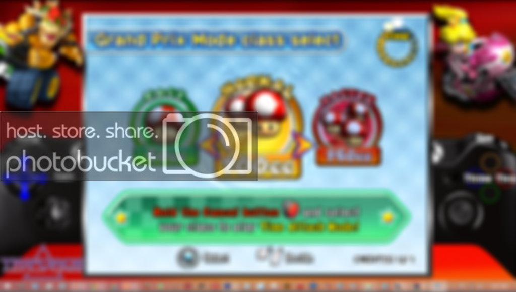

All 3 of the working games (Mario Kart GP 1, Mario Kart GP 2 and Virtua Striker 3 Ver.2002) run perfectly in Dolphin Triforce v4.0-309. There is no need to use the 'broken' v4.0-315
You need the correct .ini files and to have the correct names for the Game ID's.
EDITING\RENAMING THE GAME ID FOR MARIO KART GP 1 STOPS THE 'THROW' BUTTON WORKING!
Use a Hex editor like HxDen to update the game ID's as shown below:
Game Name | Game ID
Mario Kart GP 1 RELSAB (It HAS to be named this)
Mario Kart GP 2 GGPE02
Virtua Striker 3 Ver.2002 GVSJ8P
Here are my .ini's, all working fine:

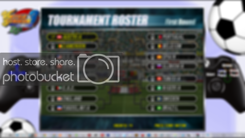

GVSJ8P.ini
[OnFrame]
$DI Seed Blanker
0x80000000:dword:0x00000000
0x80000004:dword:0x00000000
0x80000008:dword:0x00000000
[OnFrame_Enabled]
$DI Seed Blanker
Just copy/paste those into your .ini's and place in your Dolphin\User\GameSettings folder

when i launch the soccer game
title is simple virtual striker 2002 ((NOT virtual striker 3 2002))---and the game plays well just FYI
do i have the wrong rom?
i dont think so. hex editor shows me this...see image

"Virtua Striker 2002" is actually "Virtua Striker 3 Ver.2002". It's confusing but you do have the right ROM. (You have the wrong theme though! :) )

The Mario GP1 theme is in my ftp. I did not make it but I will share it as long as THK does not care. If he does I will delete it. The theme is just a .png of his unreleased THEME with the video window cut out.
i am happy to share what i am using but if he wants it gone, i will erase it
here is the pic i used from THK's theme
when his real theme is release, i will use the real one obviously
