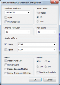

gigapig Posted April 30, 2014 Posted April 30, 2014 I didn't see a great deal of difference between 1x and 2x internal res. Here are my settings and the game screen, is that how yours looks? In HLHQ make sure you set it to fullscreen, which according to info is not true full screen.

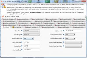

gigapig Posted May 1, 2014 Posted May 1, 2014 Well, this is an emulator issue, so I'm not worrying about HyperSpin/HyperLaunch/Modules. The second screen shot I posted, the HLHQ settings are important because they will override any settings you change in Demul. I can even set dx11, vsync off, no shaders, 16 max layers, and still get choppy video at 2x so go figure if I used your settings. Tested on Jet Grind Radio and Sonic Adventures (glitches with this one too). It's change to dx10, and everything is smooth BUT 4:3 is not 4:3, can you confirm? It may have helped to have mentioned you are trying to run a Dreamcast game on Demul. I don't use Demul for Dreamcast as NullDC is much better and probably doesn't suffer with the same issues you are experiencing. I did try Jet Grind Radio and it was OK but not great, so I still recommend NullDC. If that doesn't work, perhaps you can borrow a gaming graphics card to see if that is your issue.

Dogway Posted May 2, 2014 Author Posted May 2, 2014 "Disable Auto Sort" is checked, is that what you meant? Or do I need to edit the AHK?
DamnedRegistrations Posted May 2, 2014 Posted May 2, 2014 I haven't run every game, but I did have issues with Demul. I had to try it recently because NullDC's PuruPuru plugin was causing NullDC to crash.So I found Demul a bit glitchy, it may have been settings, but I do have decent hardware (i5 4670k & MSI 770 Lighting) so maybe that's the reason. Your right about using both emulators to run specific games, it's just a bit of a pain to setup. My vid card is obviously worse than yours but I also have a 4670k, overclocked too with aftermarket cooler. So I don't know, guess it was just the games you tried playing. Another you might want to try aside from Shenmue as a comparison between NullDC and Demul is Headhunter. NullDC (yuck) Demul Jet Set Radio and Rayman 2 are a couple more I can think of that are way better in Demul.
gigapig Posted May 2, 2014 Posted May 2, 2014 "Disable Auto Sort" is checked, is that what you meant? Or do I need to edit the AHK? Correct it should be checked.

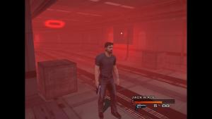

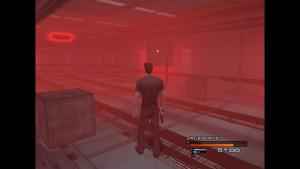

gigapig Posted May 2, 2014 Posted May 2, 2014 My vid card is obviously worse than yours but I also have a 4670k, overclocked too with aftermarket cooler. So I don't know, guess it was just the games you tried playing. Another you might want to try aside from Shenmue as a comparison between NullDC and Demul is Headhunter.NullDC (yuck) [ATTACH=CONFIG]40790[/ATTACH] Demul [ATTACH=CONFIG]40791[/ATTACH] Just curious. Was it the textures on the character that was the problem? I had a little play through on NullDC and didn't see any problems.

DamnedRegistrations Posted May 2, 2014 Posted May 2, 2014 Just curious.Was it the textures on the character that was the problem? I had a little play through on NullDC and didn't see any problems. [ATTACH=CONFIG]40798[/ATTACH][ATTACH=CONFIG]40799[/ATTACH] I wasn't on my HS computer to check, I actually got those screenshots from another forum. So Headhunter is fine in NullDC? He must've had it set up wrong then. I do know that Jet Set Radio is messed in NullDC, the character shadows go crazy. Doesn't happen in Demul. There were a few other games that happens with too.
