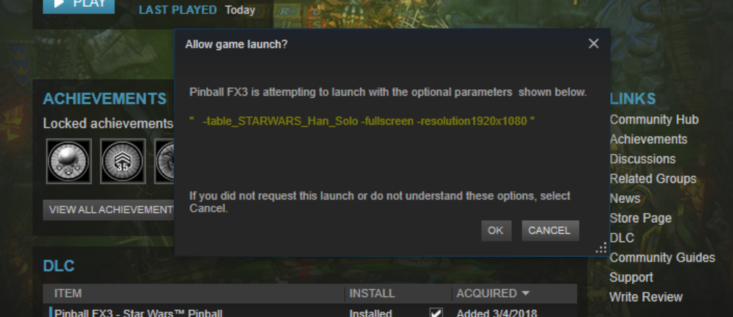

Lamaman1971 Posted December 20, 2017 Posted December 20, 2017 Hi Folks, anyone else getting the annoying dialog pop up message in steam when using Pinball FX3? "Allow game launch?". More to the point, anyone got a fix?

Lamaman1971 Posted December 23, 2017 Author Posted December 23, 2017 Apparently its the latest version of steam. Just out of interest how are you launching FX3? Im using a module based on the FX2 in Rocketlauncher....I can launch the full fat FX3 client through PCLauncher no problems.
gigapig Posted December 23, 2017 Posted December 23, 2017 On 12/23/2017 at 12:13 PM, Lamaman1971 said: Apparently its the latest version of steam. Just out of interest how are you launching FX3? Im using a module based on the FX2 in Rocketlauncher....I can launch the full fat FX3 client through PCLauncher no problems. Expand I used the temporary module posted on the RL forum.
Lamaman1971 Posted December 23, 2017 Author Posted December 23, 2017 meh. me too. grrr. bloody steam.

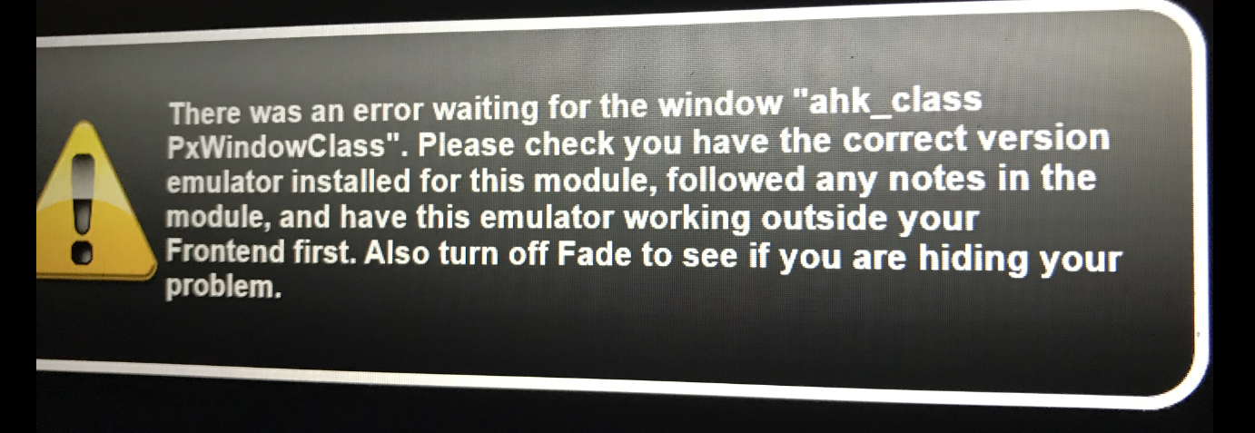

dugan26 Posted March 10, 2018 Posted March 10, 2018 Hi Everyone, Hope you are enjoying your weekend! Anyone make any progress with this error?
32assassin Posted March 10, 2018 Posted March 10, 2018 did you have the Seam version of Pinball FX2 before you installed FX3? if you did, did you enable cabinet Mode in FX2 before you switched to FX3? if you answered No to EITHER of those questions. cabinet mode settings will automatically transfer over from FX2 to FX3. IF you never had FX2 cab mode enabled; you will need to enable Cabinet Mode in FX3 before you can load a table via the module or command line mode in FX3.
dugan26 Posted March 14, 2018 Posted March 14, 2018 Was out of commission for a few days here ... I never used FX2 - I just started my Pinball collection a few days ago, to add to my Hyperspin Wheel. By the way, Pinball is INSANE! I set up Steam, and PinballX with Pinball FX3 - StarWars and Marvel Pack Tables. Everything works perfectly outside of Hyperspin with PinballX and as a stand alone - ... but i want to use Pinball FX3 with HyperSpin, because HS houses all my other emulators. I have the key for cabinet mode - In PinballX it works fine - launches right to the table. Here is a vid if you want to check it out - any help is greatly appreciated. https://youtu.be/Dw6-zF8vKn0 and these are the errors
