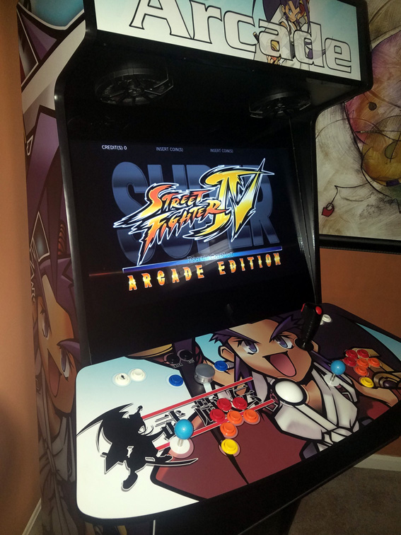

I just finished my cab and am tweaking the graphics, controls, etc.  But I did the programming on a test CP for almost 3 years.  I would recommend striving to get your system to the point where it is as stable as possible, then lock it down.  I went through and deleted a ton of the less stable games in an effort to make the arcade experience as smooth as possible for the end user.  Raiden IV, for example, or the Sega Model 2 games (Nebula Emu).  I had also removed the Demul lineup (Naomi, Atomiswave), but the recent version of that emu is just too smooth not to include it.
Back to the point - DO make sure you can easily access the usb ports within your cab so you can add games/software later (or install an external usb port).  DO get everything stable with the latest versions of everything.  Then DON'T get wound up in constant updates unless there is a dramatic benefit to doing so.  Most of the emus haven't made any dramatic improvements in over a year due to reaching saturation, and the current versions of HS and RL are very stable.

Nice arcade cabinet!!

Quick heads up on your side art - most large-format printers run at 150 dpi, so make sure your artwork is AT LEAST 150 dpi and full-scale if you want it to be crisp.  That means that at 6ft tall, your side art should have a resolution of approximately 4000 x 10,800.  Creating an image that large isn't a big deal, but that means your logo components will all need to be roughly HD resolution (say, 2000 x 2000).  If you do an image look up for each game image you want on Google, filtering by at least 2MP and higher, you should be able to find most of the classics in some form or other.  For example, a quick search for "Asteroids game" turned up an Asteroids marquee image that was 4000 pixels wide, so finding artwork shouldn't be a problem.
If you have a small image that you REALLY want on your cab, you can always use a vector converter program (Vector Magic comes to mind) to import any image, convert it to vector, then re-save it as a jpg/png/bmp/whatever at resolutions up to 10,000 x 10,000.  Vector art is lossless when enlarged, so it's ideal if you need to blow up an image to a massive scale.  Cell-shaded style artwork enlarges flawlessly, but anything with shading and gradients will be more of a challenge and might require some Photoshop-ing after the artwork is enlarged.
