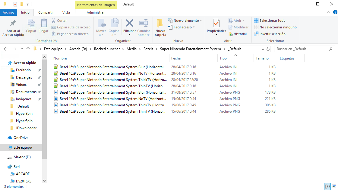

1.- To add bezels through RL just add them here:  D:\RocketLauncher\Media\Bezels\[System_Name]\_Default\
(Or wherever you have RocketLauncher folder)
Bezels must start with work Bezel to work and must have an .ini file with the coordinates.

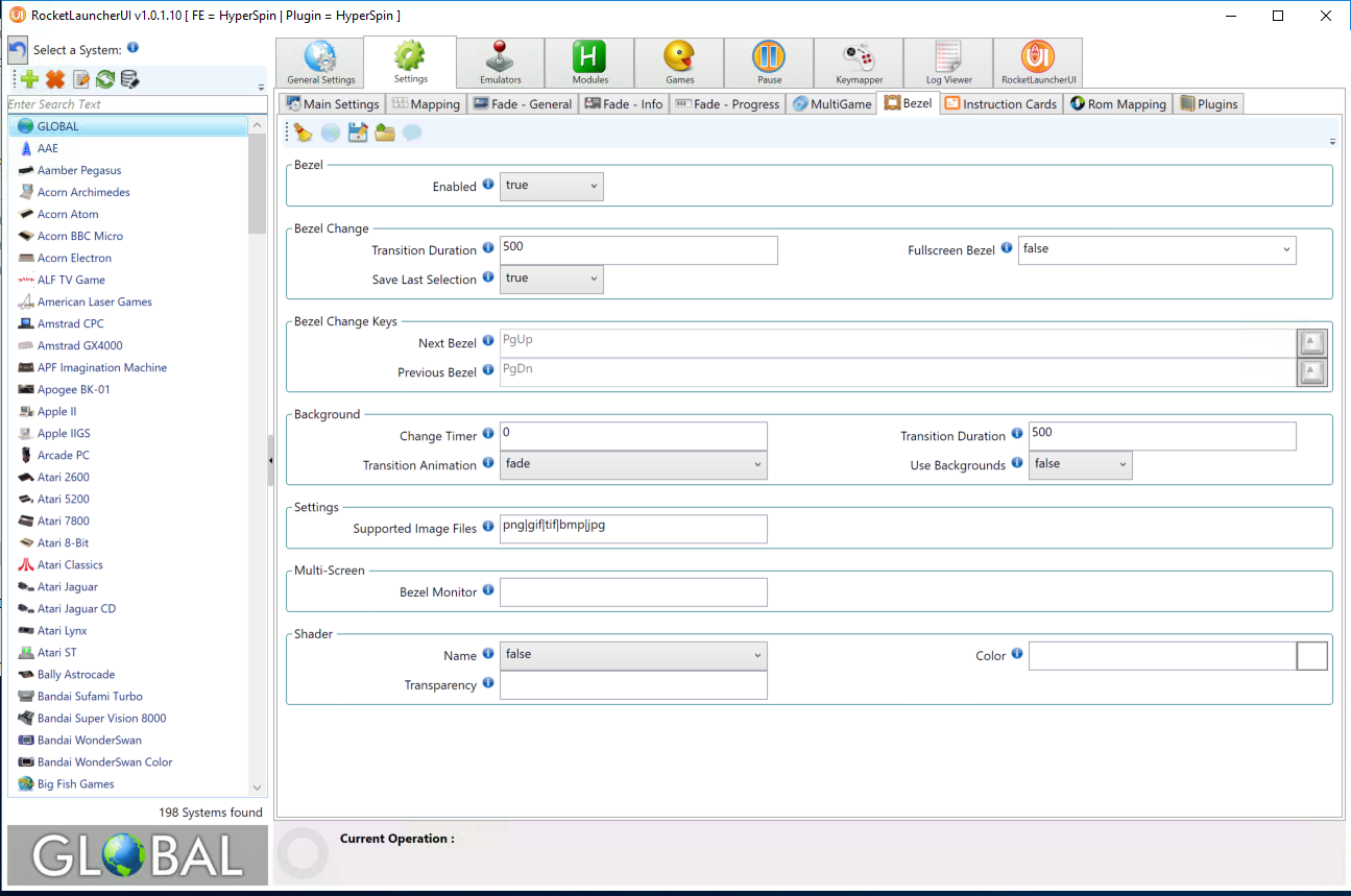

2.- Then you need to enable them on RocketLauncher UI:
GLOBAL > Settings > Bezel > Enabled = True
or do it per system.

For some reason the media directory structure does not include a bezel's folder, but I'll create it as Ci2 is showing me in the next response. Thx

Ill be in front of my build a little later today and will try and walk through this step by step and see if it works as I hope. Thanks for the detail and I'll let everyone know shortly. Thanks a ton ...
UPDATE - So I re-downloaded the standard RL Media Starter Pack as well as the Unified Bezel Pack from Ci2 and used it to make sure the directory structure and content were all correct and have Bezels working :good:
