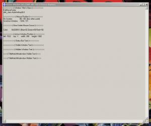

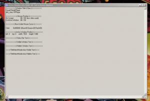

JaronSenna Posted February 13, 2013 Share Posted February 13, 2013 got it, thanks for making that clear Blur :-) I made two screenshots. The first one is after I launced a table (AFM), started playing and plunged the first ball, then pressed the exit button to bring up the fplaunch menu: Then, without me touching anything, it changes to this after a second, maybe less: It seems that the focus automatically changes back to vpinball? I am using the 9.1.4. exe (minimal install on top of vp 9 from the vpforums. Link to comment Share on other sites More sharing options...
blur Posted February 13, 2013 Share Posted February 13, 2013 make a screenshot with tiny winspy window so that i can see menus and vp also set debugmode to file and post your log.txt file after one game did you try to open menus several times? it's not good to open menu right away when table starts - fplaunch needs few seconds to make hiscore and other things Link to comment Share on other sites More sharing options...
JaronSenna Posted February 13, 2013 Share Posted February 13, 2013 I put the screenshot and the log.txt in a shared dropbox folder, since the screenshot is quite large: https://www.dropbox.com/...nF I cut off the backbox image, and only left the (rotated) playfield image with the AFM table, with FPLaunch on top and the small winspy window on top of that. Hope it helps making things clear... Link to comment Share on other sites More sharing options...
blur Posted February 14, 2013 Share Posted February 14, 2013 can you put log.txt here, i can't access dropbox from work, i saw screenshot this morning and it looks ok Link to comment Share on other sites More sharing options...
JaronSenna Posted February 14, 2013 Share Posted February 14, 2013 Sure, here goes: 09:02:05 PM | HyperSpin Started 09:02:05 PM | Setting up monitors 09:02:05 PM | Starting Backglass 09:02:05 PM | Startup Program Unvavailable 09:02:05 PM | Visual Pinball.xml found 09:02:05 PM | Dual monitor found 09:02:05 PM | Starting Playfield 09:02:05 PM | Auto Detect is on 09:02:05 PM | Playfield monitor is not rotated 09:02:05 PM | Setting Playfield rotation to 270 09:02:06 PM | xml loaded 09:02:06 PM | Visual Pinball.xml found 09:02:06 PM | xml loaded 09:02:06 PM | Loading wheel images 09:02:06 PM | Entering Menu 09:02:09 PM | Pausing Animations 09:02:09 PM | Running FPLaunch.exe 09:02:09 PM | Command Line is: FPLaunch.exe "Visual Pinball" "AFM_vp914_v2.4FS" 09:02:09 PM | Ini files parsed p m f i 09:02:10 PM | Flyer Pages Parsed p0 m0 f0 i0 09:02:10 PM | Instruction Pages Parsed p0 m0 f0 i0 09:02:10 PM | bigboss Called p0 m0 f0 i0 09:02:10 PM | rosve Called p0 m0 f0 i0 09:02:10 PM | CreateLoadingScreen Called p0 m0 f0 i0 09:02:10 PM | Loading Loop 1 p0 m0 f0 i0 09:02:10 PM | Loading Loop 2 p0 m0 f0 i0 09:02:10 PM | Loading Loop 3 p0 m0 f0 i0 09:02:11 PM | Loading Loop 4 p0 m0 f0 i0 09:02:11 PM | Loading Loop 5 p0 m0 f0 i0 09:02:11 PM | Loading Loop 6 p0 m0 f0 i0 09:02:11 PM | Loading Loop 7 p0 m0 f0 i0 09:02:12 PM | Loading Loop 8 p0 m0 f0 i0 09:02:12 PM | Loading Loop 9 p0 m0 f0 i0 09:02:12 PM | Loading Loop 10 p0 m0 f0 i0 09:02:12 PM | Loading Loop 11 p0 m0 f0 i0 09:02:13 PM | Loading Loop 12 p0 m0 f0 i0 09:02:13 PM | CheckVP - VP is active p0 m0 f0 i0 09:02:13 PM | LoadingScreen Closed - Esc? p0 m0 f0 i0 09:02:13 PM | CloseProgress Called p0 m0 f0 i0 09:02:13 PM | CheckVP - VP is active p0 m0 f0 i0 09:02:13 PM | WaitVP Called p0 m0 f0 i0 09:02:16 PM | CheckVP - VP is active p0 m0 f0 i0 09:02:16 PM | WaitVP Called p0 m0 f0 i0 09:03:14 PM | ExitScreen called p0 m0 f0 i0 09:03:15 PM | PauseGame Called p0 m0 f0 i0 09:03:15 PM | PauseVP Called p0 m0 f0 i0 09:03:15 PM | ExitMenu Called p1 m0 f0 i0 09:03:39 PM | MoveDown Called p1 m1 f0 i0 09:03:39 PM | MenuSwap Called p1 m1 f0 i0 09:03:39 PM | Exit Menu Swapped - Item 2 p1 m1 f0 i0 09:03:40 PM | MoveDown Called p1 m1 f0 i0 09:03:40 PM | MenuSwap Called p1 m1 f0 i0 09:03:40 PM | Exit Menu Swapped - Item 3 p1 m1 f0 i0 09:03:40 PM | MoveDown Called p1 m1 f0 i0 09:03:40 PM | MenuSwap Called p1 m1 f0 i0 09:03:40 PM | Exit Menu Swapped - Item 4 p1 m1 f0 i0 09:03:41 PM | MoveDown Called p1 m1 f0 i0 09:03:41 PM | MenuSwap Called p1 m1 f0 i0 09:03:41 PM | Exit Menu Swapped - Item 5 p1 m1 f0 i0 09:03:41 PM | selectItem Called p1 m1 f0 i0 09:03:41 PM | ExitScreen called p1 m1 f0 i0 09:03:41 PM | PauseGame Called p1 m1 f0 i0 09:03:41 PM | PauseVP Called p1 m1 f0 i0 09:03:41 PM | ExitMenu Called p0 m1 f0 i0 09:03:41 PM | closeMenus Called p0 m0 f0 i0 09:03:41 PM | Exit Menu Closed - CloseGame p0 m0 f0 i0 09:03:41 PM | CloseGame Called p0 m0 f0 i0 09:03:41 PM | CloseVP Called p0 m0 f0 i0 09:03:41 PM | rosveClose Called p0 m0 f0 i0 09:03:41 PM | bigbossClose Called p0 m0 f0 i0 09:03:43 PM | ExitScript Called p0 m0 f0 i0 09:03:43 PM | onExitScript Called p0 m0 f0 i0 09:03:43 PM | GDI+ Unloaded p0 m0 f0 i0 09:03:43 PM | COM Unloaded p0 m0 f0 i0 09:03:46 PM | Quiting program 09:03:46 PM | Exit Program Unvavailable 09:03:46 PM | Bye! Link to comment Share on other sites More sharing options...
blur Posted February 14, 2013 Share Posted February 14, 2013 All looks ok - so while you are in a menu you lose focus on menu and vp gets focus back and ball goes down the drain? Link to comment Share on other sites More sharing options...
