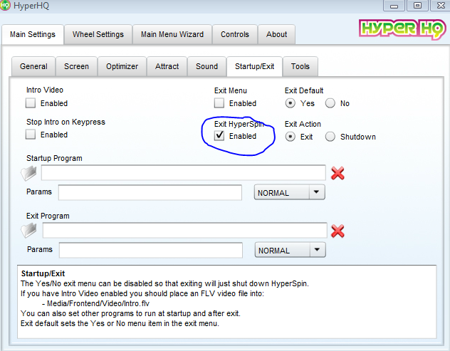

Spawk Posted October 30, 2018 Posted October 30, 2018 Also, exiting of HS can be set here: Most arcade setups disable this as they don't want users backing right out to windows.
Tedadar Posted October 31, 2018 Author Posted October 31, 2018 6 hours ago, Spawk said: The controls look right in HQ so something else must be interfering. It's important to note what you are using for controls. Arcade (ipac)?, Joypads? and what kind sometimes (xbox/ps, tankstick, wireless?) Ipacs and stuff usually have their own config programs. Joypads usually need an external keymapper like joytokey or xpadder. Are any of these being used? I've had also the suggestion that one of those are interferring the commands. Actually I disabled the keymapper program (it won't starts by system bootup anymore), to get sure, that it won't cause the problem. But it have not changed the problems in Hyperspin. Also the "Exit Hyperspin" Option is set in my System. I used to shutdown the computer with it, when I close Hyperspin.
