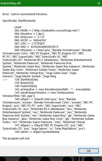

grzybiarz Posted January 17, 2019 Author Posted January 17, 2019 These are files for rocketlauncher - hyperspin has a different specification. It does not work on the hyperspin
grzybiarz Posted January 17, 2019 Author Posted January 17, 2019 and video (amazing frontend!): I thought it would combine posts
gigapig Posted January 17, 2019 Posted January 17, 2019 4 hours ago, grzybiarz said: and video (amazing frontend!): I thought it would combine posts I'll take a wild guess and say you're either not using Rocketlauncher (from where the ahk was pulled) or your version of Rocketlauncher is out of date.
pinsanity Posted January 18, 2019 Posted January 18, 2019 If you look at the video posted all the system names are incorrect and don't match official names that would be recognised by RL in order to load. EG: Saturn should be Sega Saturn. Official listing: http://hyperlist.hyperspin-fe.com/
grzybiarz Posted January 18, 2019 Author Posted January 18, 2019 I know that the names are different. I change names, but the remaining systems work. I change folders and xml files. AHK for hyperspin are simple: RunWait,% executable% "% romName%",% emuPath% Process, WaitClose, DOSBox.exe Gui Destroy ExitApp CloseProcess: return For RockeLauncher they are complicated
