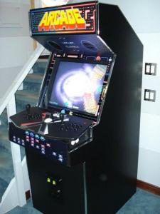

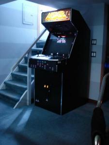

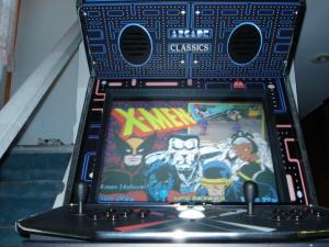

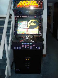

dark Posted January 23, 2011 Posted January 23, 2011 I built this cabinet out of 3/4'' birch plywood and painted each piece of wood with a minimum of 3 coats oil primer 3 coats black oil low lustre paint. The "defender Arcade" marquee I bought off the internet but the other graphics I designed myself based off of pac-man and galaga game play. (May do side art later). I used a custom cut piece of tempered glass for my overlay which has pacman bezel/border decal applied on the inside of the glass. A cool feature I included with my cabinet is the entire coin door front panel is attached to the cabinet with industry quality velcro making access to the inside of the cabinet very easy. I installed a 6 port USB hub on the front of my pc so if i need to adjust any USB's I can usually do it just from going through the coin door. Specs 27'' WG Arcade monitor w/ bezel 2.8ghz quad core pc X-Arcade 2player joystick with trackball 2x wired playstation style gamepads (for 4 player games etc) 1x wireless 6 button gamepad (to simulate n64 controls) 2x ems top gun light guns. Chrome T-moulding (which I've only seen at starburstcoinmachines.com, local to me) Black T-moulding on Galaga drawer cover. I have a fairly robust collection of system wheels that continues to grow and I owe the quality of my front-end experience to the amazing hyperspin community. No other front end compares. ------------------------------------------------------------------------------------------------------------------------- <EDIT> Update: My new "warlords" custom cocktail table: http://www.hyperspin-fe.com/forum/showthread.php?t=14339 Update: New side art done on upright cabinet: http://www.hyperspin-fe.com/forum/showthread.php?t=14471 next project: Custom CP for upright and likely give x-arcade to my friend. I considered just putting new artwork on my x-arcade cp, but theres a few things I'd like to change about it and I'd be more satisfied over all if I made it from scratch.
