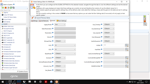

Mame has changed something lately, in RocketLaunche the old AHK (0.186 i think) works with 0.214 but you have to set it this way.
Okay, so the good news is that the option changes for the mame.ahk in Rocket Launcher as recommended by @dark13 worked and I can launch Mame with RL with my nice BGFX settings!
The bad news is that that .ahk alteration doesn't work for 0215, so I've reverted to the 210 no-nag that @dark13 supplied me earlier.
