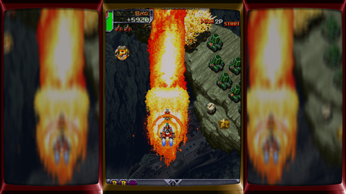

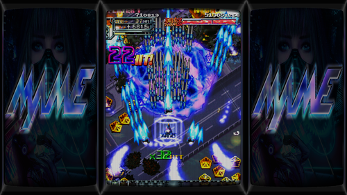

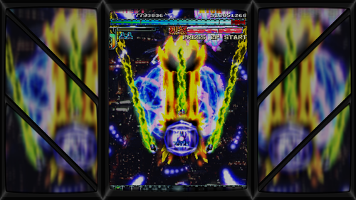

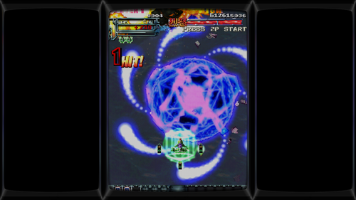

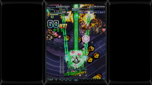

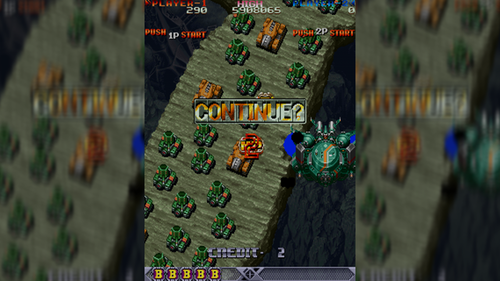

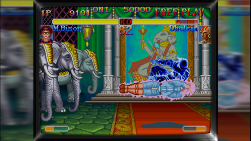

pacifikballa Posted June 20, 2020 Posted June 20, 2020 **UPDATE** 06/27/2020 - I have uploaded 3 zips and Instructions on how to achieve this. It is very self explanatory. The files are too big to upload here, so I will provide links to my Drive. Test it out, let me know how it looks for you. Thanks. https://drive.google.com/file/d/1Ah7SDdf5CpC_y2Uf-XbI07VxqUU2kCcI/view?usp=sharing https://drive.google.com/file/d/1JnB6Oju_6Wtfykx7cEmbnJYO8bX0VNOG/view?usp=sharing https://drive.google.com/file/d/1oirxP8Q5H0lZzp4s9F_5jftP87G324q_/view?usp=sharing https://drive.google.com/file/d/1sSe1YWRJCNbskQhkrYudZaXSSXa9bP93/view?usp=sharing Whats goin' on everyone. So I got tired of the black bars on the side of MAME when running my games. I don't like most bezels as they are too clean looking. I opted to modify the game system/individual rom .ini files by changing the BGFX chain. My goal is to get a basic tv style frame bezel in the center screen, but I am still working out how to do that. But for now, I'm diggin' this effect. Best viewed in 4K/fullscreen..that is my native resolution. Let me know what you think.

pacifikballa Posted June 22, 2020 Author Posted June 22, 2020 Still fudging around with it...I got the bezel around the center pane...but am unable to figure out how to add the pillarbox effect to the sides...not sure what order to put things in when editing the .lay file. Will keep playing with it.

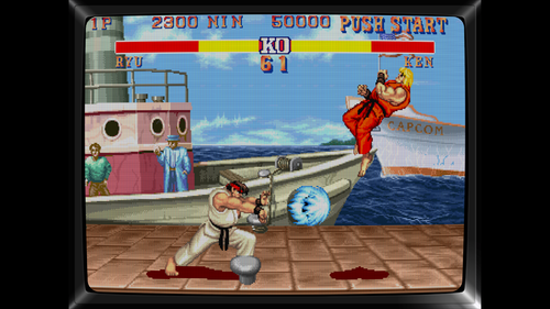

pacifikballa Posted June 23, 2020 Author Posted June 23, 2020 With assistance from one of the M.A.M.E devs, he seen a minor issue with my .lay file and revised it. Now I can have BOTH effects! Check it out! (view in 4K, video may still be processing)
pacifikballa Posted June 23, 2020 Author Posted June 23, 2020 Got it set up for horizontal games now! Will post a vid in a few minutes...I'm stoked!

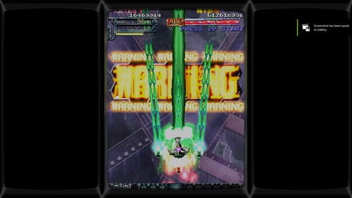

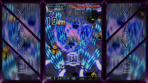

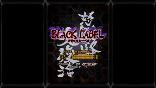

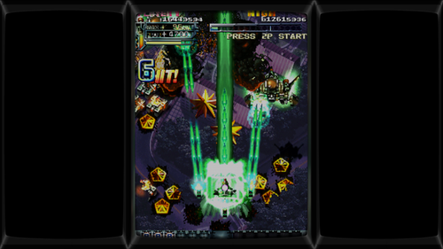

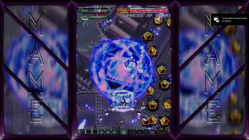

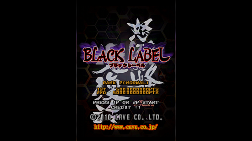

pacifikballa Posted June 27, 2020 Author Posted June 27, 2020 I'll be posting up instructions and files soon. Should be a quick drag and drop and a quick edit of the mame.ini and vertical .ini. I will include just a standard black bezel which can be changed to whatever color u want. I was able to achieve a cool effect...it is very subtle, but it looks cool. By overlapping the pillarbox effects a little into the center bezel, you can see a glow effect on the inside of the center bezel, like one would see on the bezel of a television when watching tv at night. The pics below show how it looks. Revision #1, shows off what will be my go to setup on my vertical games, Revision #2 shows off that inner bezel glow effect I mentioned earlier

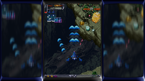

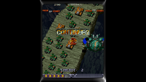

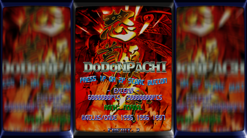

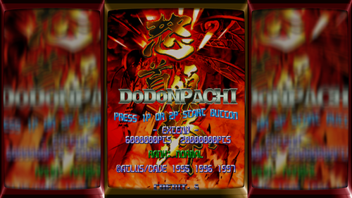

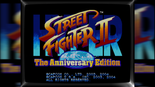

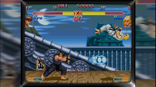

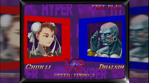

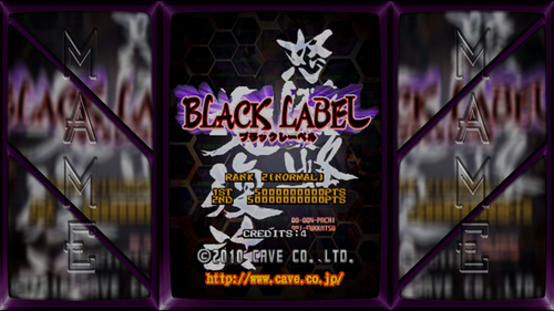

pacifikballa Posted June 28, 2020 Author Posted June 28, 2020 I made the inside center bezel semi-transparent and pulled in the pillarbox effects into the transparent part. I think it looks sick! I'm just using the same bezel and game as reference...sorry if it gets old New pics and a video below...thoughts? Video may still be processing, best viewed in 4K.

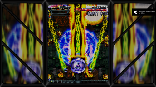

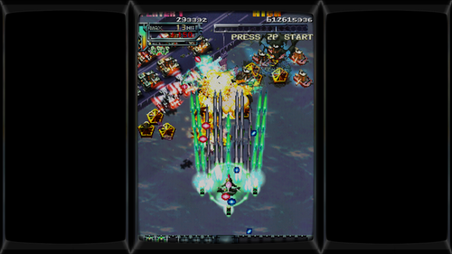

pacifikballa Posted June 28, 2020 Author Posted June 28, 2020 Just a little update in case anyone is interested This pic shows the pillarbox effects squeezed just outside the center without the semi-transparent bezel This pic shows the semi-transparent bezel over the pillarbox effects..adds a nice glow effect when in action

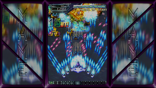

pacifikballa Posted June 30, 2020 Author Posted June 30, 2020 Took it to the next level (still processing, view full screen 4k to see what I'm talking about)

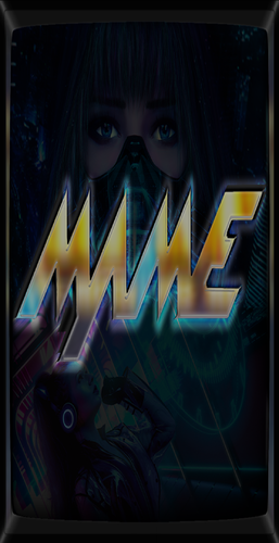

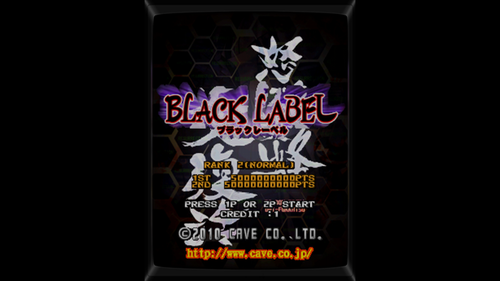

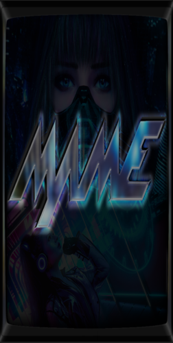

pacifikballa Posted June 30, 2020 Author Posted June 30, 2020 Now that the triple glow bezels are complete, I can spend more time customizing how I want the inside to look...testing this right now.....transparent MAME logo with the pillarbox effects behind it...

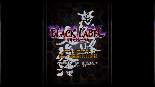

pacifikballa Posted July 2, 2020 Author Posted July 2, 2020 even more watch the video...keep your eyes on the eyes and headphone...its still a W.I.P
