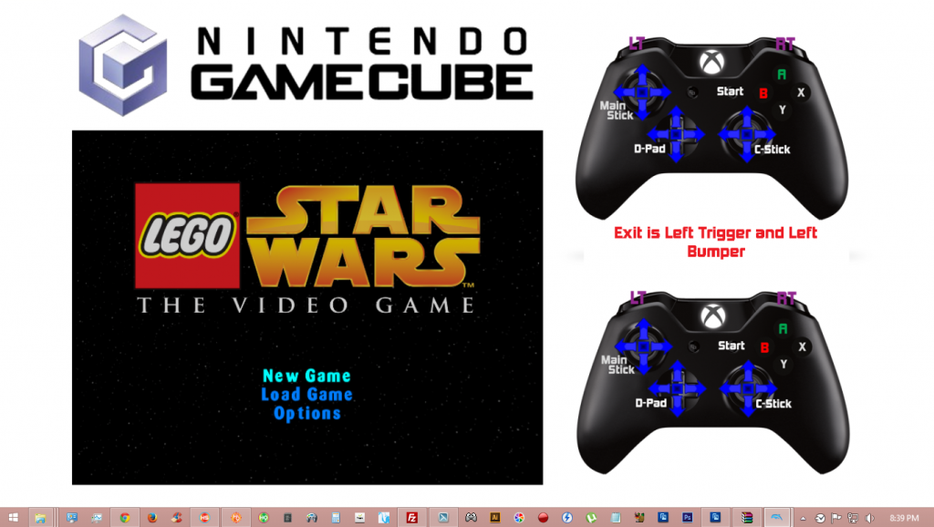

craiganderson Posted June 25, 2014 Posted June 25, 2014 I wanted a bare bones dolphin module that did nothing more than load a game (gamecube). I had noticed that outside of hyperspin the gamecube games loaded very fast. But inside hyperspin the cursor would do that little spinny thing forever and the game would sometimes not run correctly (even though it was loaded).... So i put this togther. It works super fast but has NO bells or whistles it just loads a rom and puts it in my bezel.... just fyi if someone wants it i took the Run Command Line from the real dolphin module im not a command line expert but it works perfectly on my system so far just sharing what i have MEmu = Dolphin MEmuV = v4.0 MURL = http://www.dolphin-emulator.com/ MAuthor = craiganderson MVersion = 1.0 MCRC = iCRC = MID = MSystem = "Nintendo Gamecube" ;---------------------------------------------------------------------------- StartModule() BezelGUI() FadeInStart() 7z(romPath, romName, romExtension, 7zExtractPath) BezelStart() Run(executable . " /b /e """ . romPath . "\" . romName . romExtension . """", emuPath) WinWait("ahk_class wxWindowNR") WinWaitActive("ahk_class wxWindowNR") BezelDraw() FadeInExit() Process("WaitClose", executable) 7zCleanUp() BezelExit() FadeOutExit() ExitModule() CloseProcess: FadeOutStart() WinClose("ahk_class wxWindowNR") Return http://craigandersonthemes.weebly.com/
