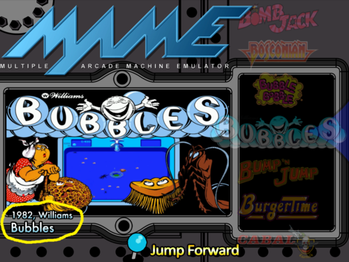

javeryh Posted July 23, 2020 Posted July 23, 2020 I'm trying to make my own theme but I cannot figure out how to remove the yellow circled text in the picture I attached. The toggles in Hyper HQ modify it somewhat but I'm not seeing an option to remove it completely. Thanks.

dark13 Posted July 23, 2020 Posted July 23, 2020 Settings/MAME.ini game_text_active=false show_year=false show_manf=false show_description=false Automatizing infopanels creation from .csv files for HTPCs themes (look at infopanel tutorial.zip on the ftp in dark13 folder) PNGs to SWFs automatized flash scripts Hyperspin Wheelset automatized template (photoshop's variables + batch) Aeon nox 4.13 W.I.P. hyperspin skin
javeryh Posted July 23, 2020 Author Posted July 23, 2020 1 hour ago, dark13 said: Settings/MAME.ini game_text_active=false show_year=false show_manf=false show_description=false There it is. Thanks so much!!
