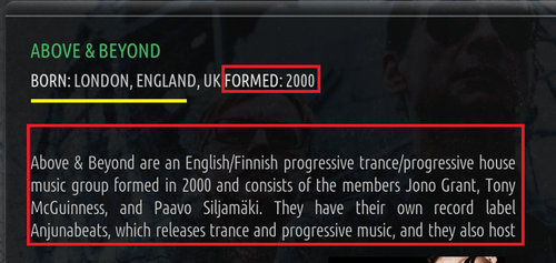

shredder Posted October 4, 2020 Posted October 4, 2020 Can anyone tell me if there is a tool/plugin/add-on that exists to display information (i.e. a game bio) onscreen, preferably with an auto scrolling capability and allow for x,y, coordinate placement on a theme? Kinda similar to this...(just did a quick google search for a visual example)

shredder Posted October 5, 2020 Author Posted October 5, 2020 After doing some more...outside the box, thinking, i guess this could be incorporated via some sort of card or art slide as a layer on a per item basis...but that is a LOT of extra work....I was really hoping for some way to create an xml or ini file that would pull in the info depending on whatever item is highlighted on the wheel..... @Avar Is there any way that you can think of be it conventional or unconventional that adding text bios can be incorporated? I've seen something similarly incorporated as an SWF here, but again deving something like that for each item would take ages. I'm looking for something that functions similar to Hyperspeech...but instead of spoken word, displays text and to be able to set the text "container" (for lack of a better word) either globally or on a per system or theme basis
