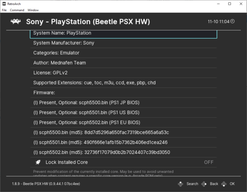

Creezz67 Posted October 11, 2020 Posted October 11, 2020 24 minutes ago, NEO207 said: Thanks i will check the module for dolphin... with retroarch... to be more precise, i only have a problem starting ps1 games, i managed to sort out the problem with other systems. i wanted to change from ePSX to retroarch to have almost every system running on retroarch (better compatibility, same commands, etc.)... do i have to add something in the module so that ps1/psx games run through rocketlauncher/hyperspin? kind regards and thanks! For PS1, i have found using mednafen_psx_hw_libretro core works best, using bin/cue or chd format If you want to use multi game for Disc1 / Disc2 etc i needed to convert those games into pbp format for them to work on certain cores correctly (e.g. duckstation core) Just make sure you add the following info in the module, for example this: Sony Playstation|LibRetro_PSX|mednafen_psx_hw_libretro|psu Sony Playstation Japan|LibRetro_PSX|duckstation_libretro|psu Sony Playstation Europe|LibRetro_PSX|pcsx_rearmed_libretro|psu Check you have correct bios files for whatever core you are using, just load core and look in information tab for details below :
