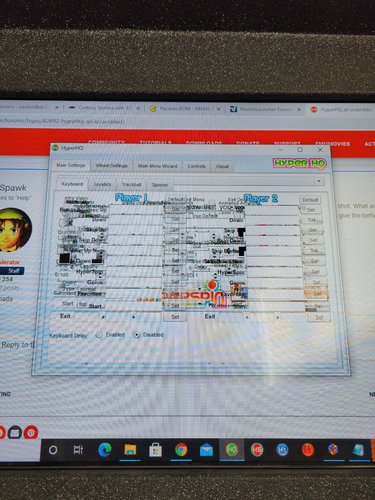

tweeder Posted February 21, 2021 Posted February 21, 2021 Been a few years since i started this arcade so im redoing it all from the beginning. I'm trying to get thew Hyper hq wheel as per the video. Except the app is all scrambled with layer upon layer. I seen another post saying they re unzipped the file but that didnt work for me.
Spawk Posted March 8, 2021 Posted March 8, 2021 Maybe some more information will help. As per what video? Have a link? Perhaps take a screen shot. What are using for a monitor? What resolution? What operating system might be important. The more info you can give the better the chance someone may see what the problem is.
tweeder Posted March 8, 2021 Author Posted March 8, 2021 I open up HQ and this is what shows up, I have reinstalled it and it's still the same. I'll have to look for the video, it was a tutorial on YouTube. U am using a TV monitor in a arcade cabinet I built. I'm using windows 10.
Spawk Posted March 8, 2021 Posted March 8, 2021 Interesting, not sure exactly what would cause this. You could try disabling some windows features like anything "Aero" or possibly "desktop composition"??? Does HS itself run fine? Is Win10 updated? Did you need the sxs.dll? I know it's not ideal but if HS itself displays correctly, all the settings in HQ can be edited in "notepad" from the various ini files in the "settings" folder.
tweeder Posted March 8, 2021 Author Posted March 8, 2021 I just checked HS and no it doesn't do anything. It highlights in the taskbar at the bottom but doesn't do anything.
Mrmikey73 Posted March 10, 2021 Posted March 10, 2021 I had that happen when I copied my hard drive. Not sure if it was a bad copy but I had to reformat the copied drive and then recopy it and it was fine.
tweeder Posted March 11, 2021 Author Posted March 11, 2021 I installed that download into my hyperspin folder and extracted it. It asked to override some files that were already there so i allowed it but it still didn't work.
gigapig Posted March 12, 2021 Posted March 12, 2021 We have had this crop up from time to time and think it's due to a bad ini file found on the settings folder. You could try removing yours to a backup folder and then copy the default ones across from the Hyperspin download.
