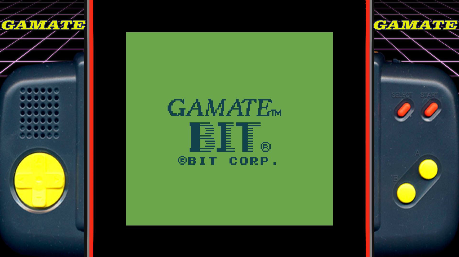

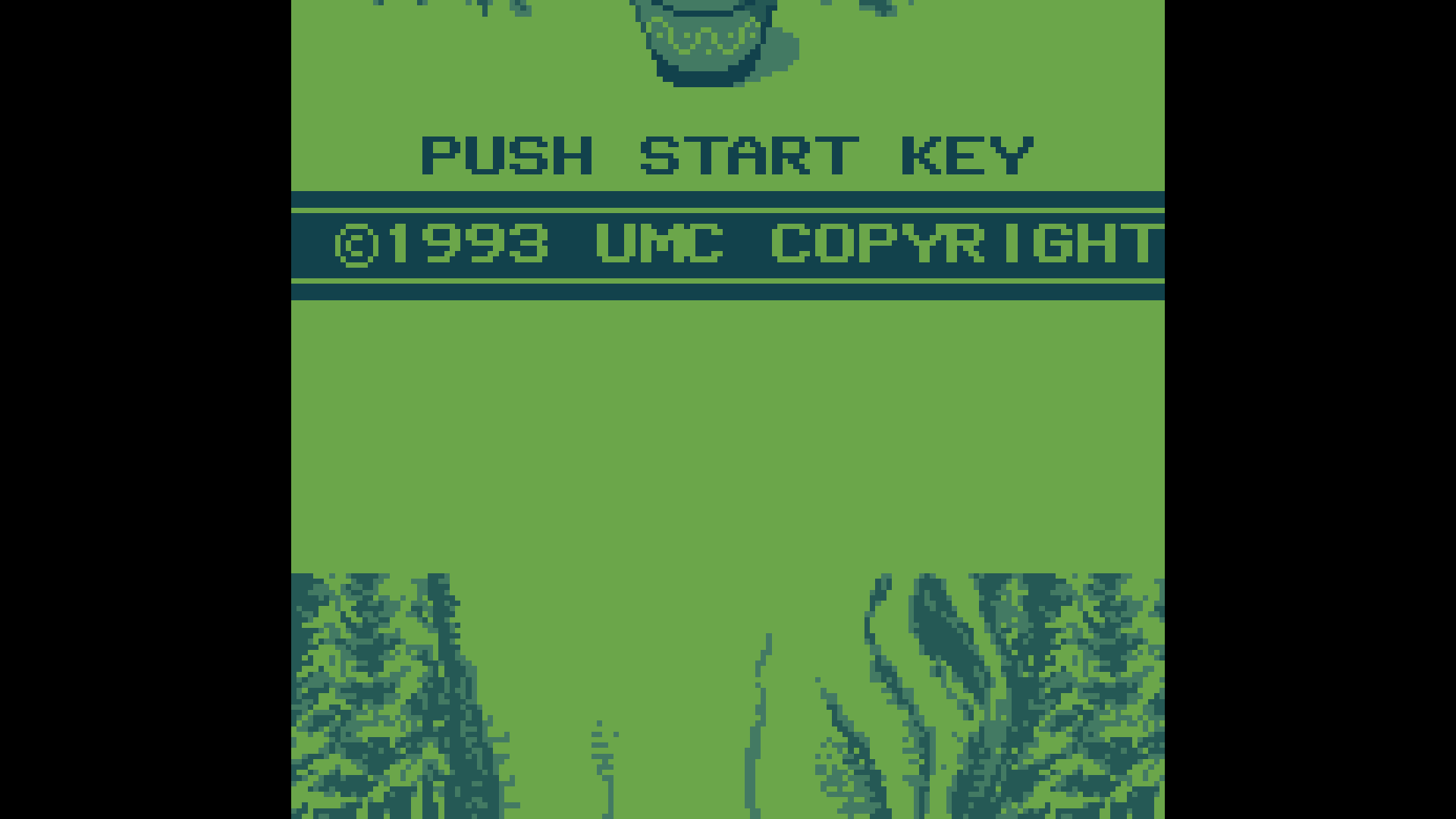

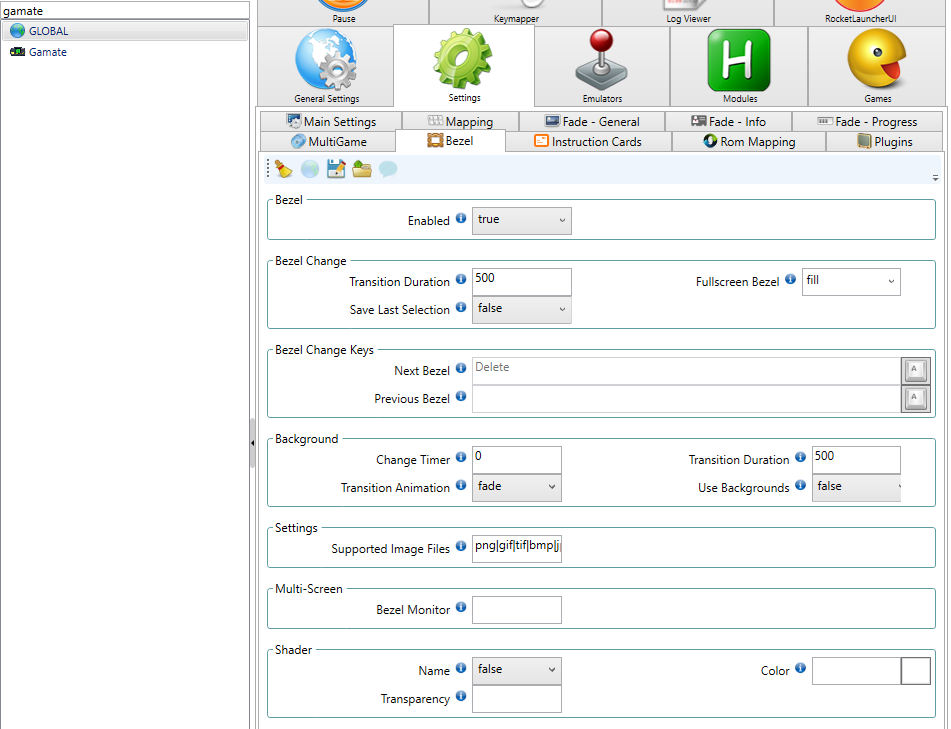

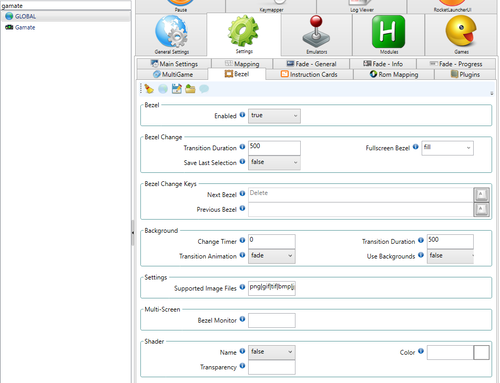

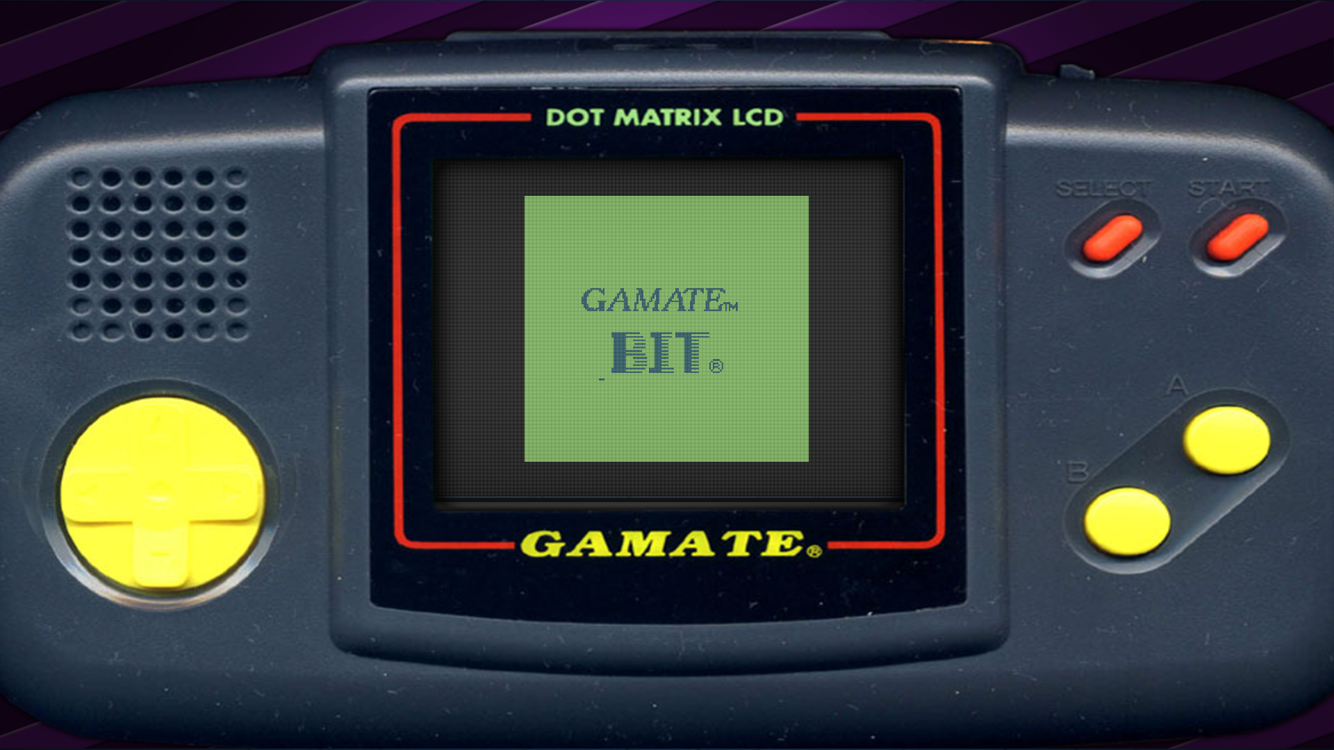

PsyKos77 Posted May 5, 2023 Posted May 5, 2023 Hello everyone, do you know why I don't have the display of the entire games on the bezel? Here is the example with the Gamete system. I tried several options in RocketLauncher to no avail. Thank you very much for your feedback.
Dunkler2Engel Posted May 5, 2023 Posted May 5, 2023 The first thing you have to see is if in retroarch you see the black borders, if you see them without bezels, you have to adjust video options in retroarch, it is not a Rocketlauncher thing. Other thing you can do if no want to touch the video options is edit the ini file that comes with the bezel if you open the ini you see 4 lines like this Bezel Screen Top Left X Coordinate=390 Bezel Screen Top Left Y Coordinate=0 Bezel Screen Bottom Right X Coordinate=1680 Bezel Screen Bottom Right Y Coordinate=1080 The 2 first lines define where the screen start in pixels, first horizontal, and second vertical coordinate, you can see exactly if you open the image with the same name in paint and look in bottom left of the paint window it show the pixel exact you are with the mouse. And the 2 last lines, define where the screen end in pixels. Only you need the edit the numbers to force the black borders to stay out the bezel.
brudibru Posted May 5, 2023 Posted May 5, 2023 Maybe you can also try this bezel. The display's much smaller but also more realistic. There's still the black borders but it doesn't look that bad. You can also probably adjust the bezel.ini following the method provided by Dunkler2Engel. _Default.zip

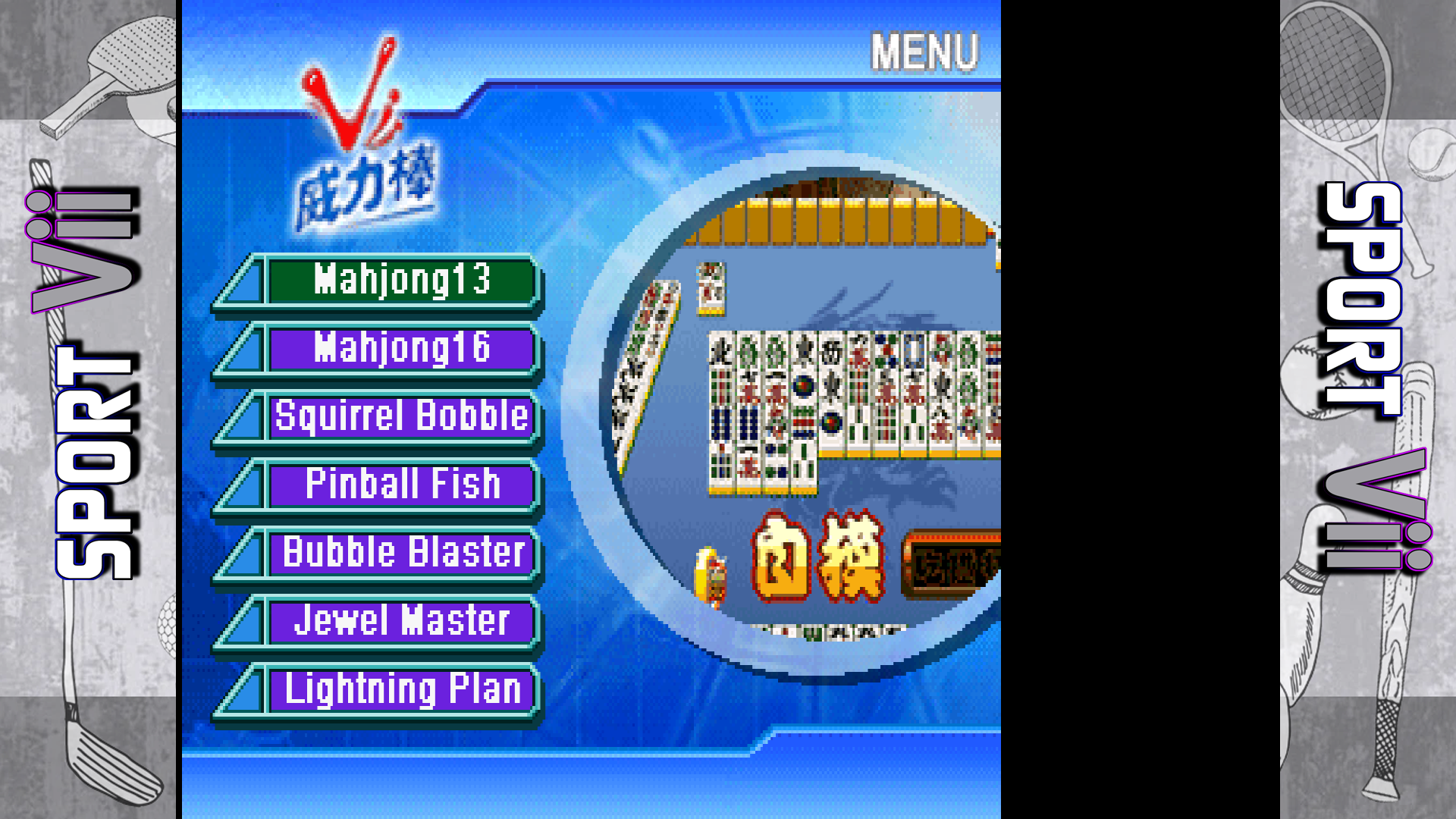

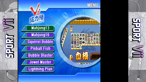

PsyKos77 Posted May 5, 2023 Posted May 5, 2023 Thank you for your answers. This does not only happen with Gamate but several systems. That's why I thought it was from RocketLauncher. Here is what I have directly with RetroArch, it seems good suddenly no? I don't quite understand what's wrong...
Dunkler2Engel Posted May 5, 2023 Posted May 5, 2023 If you open with the bezel a god method to see if the bezel is well set, is to open retro arch menu, if you see it well in all the screen the black borders need to be fixed with retroarch. I was try with the bezel shared by Brudibru, and not show in full scren only adjust it vertical, but horizontal have black lines. Looking in retro arch config if in Core options in the quick menu disable "Alternate Render Method", and in Settings, Video, Scalling set Full, you see it in all the screen. But Floatingyeti in her guide said the "Alternate Render Method" is a Must have so, i dont know if it can affect this systems or others
floatingyeti Posted May 9, 2023 Author Posted May 9, 2023 On 5/5/2023 at 10:32 AM, PsyKos77 said: Hello everyone, do you know why I don't have the display of the entire games on the bezel? Here is the example with the Gamete system. I tried several options in RocketLauncher to no avail. Dunkler2Engel and Brudibru both provide great suggestions so you might have already fixed the issue. If not, show us screenshots of your RetroArch (MAME core) options. I'm sure one of us can identify the issue based off your settings.

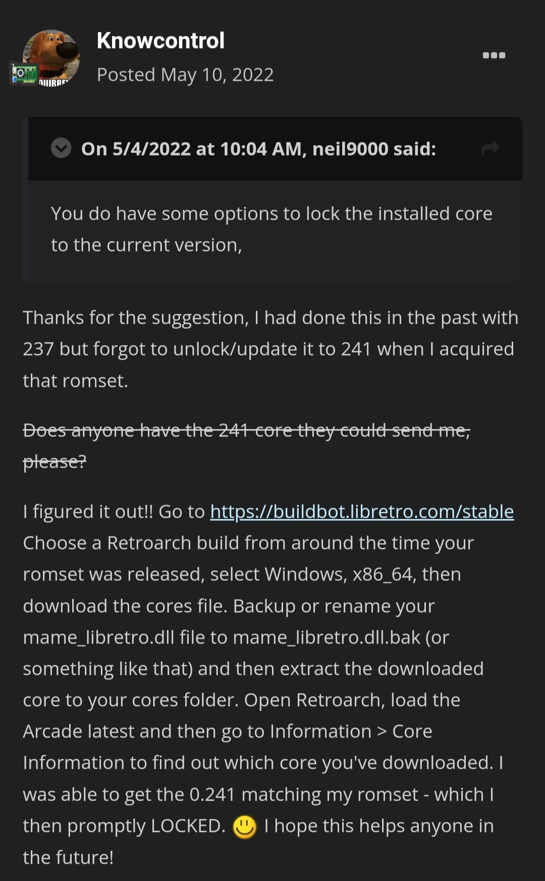

floatingyeti Posted May 9, 2023 Author Posted May 9, 2023 On 5/5/2023 at 3:59 AM, Dunkler2Engel said: Yes Tower of Druaga is tthe game that show me this error i was try with the last mame list and have the same message. I tried with multiple versions of MAME but it wouldn't load the game. Mackano has the best solution of going through the buildbot archive and checking the older versions of MAME but I was unsuccessful. It seems that druaga.d88 image is not detected by MZ-2500 as a floppy disk. It is behaving like the floppy disk image is corrupt. For now, I'm going to remove the game from my database.
