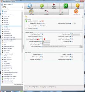

Or uncheck "Valid Module/Emulator only"
[ATTACH=CONFIG]42546[/ATTACH]

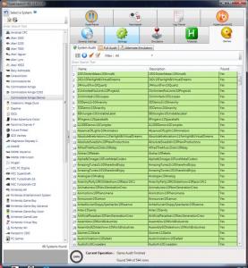

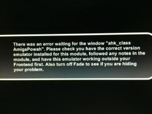

Got the XML all green when i launch a demo now i get this error
Has the emulator started? Or is it running when the error is gone?
If not try turning off or setting 7z to false.
I've tried mine again with WinUAE Loader and it just crashes, so I have given up with that for the moment.

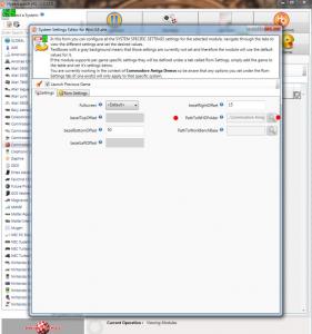

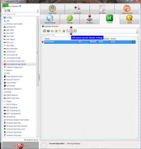

You then need to go here and here. And maybe change your path to your WHD folder.

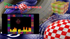

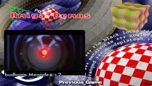

I did a basic theme also.
Just finished up a video snap for Amiga Demos. The very slightly modified module and associated media is in my ftp folder. /Upload Here/gigapig/Commodore Amiga Demos/Media/Wheel
