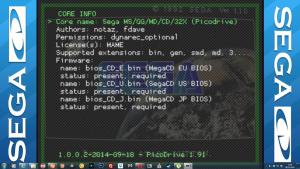

gigapig Posted December 8, 2014 Posted December 8, 2014 So your not getting that error anymore, RetroArch is loading at sitting at the Sega CD bios screen. Can you access the core information screen?
DrMaxwell Posted December 9, 2014 Posted December 9, 2014 Yes, I can access the Core Menu. Is there a setting I need to flip in order for it to load the disc and not just the bios? I wonder why it isn't loading the rom... How to guides and custom artwork sets @ https://www.youtube.com/user/MaxwellParadigm Themes, Wheels, Carts and Database Downloads available @ http://spacevalkyrie.weebly.com/
