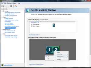

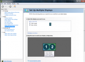

gigapig Posted November 9, 2014 Posted November 9, 2014 I know it's quite simple to do but here's what I do.
