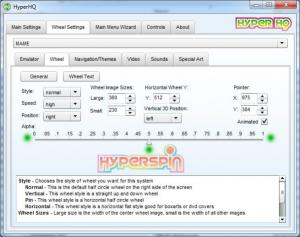

All I can see that you can do is to adjust the Alpha so the image doesn't fade so much and it's not so jarring.
I've now set mine to .5 which is a good compromise, trouble is you have to do it for each system but you can change it in the ini files for each system. :\Hyperspin\Settings

And I don't wnat to edith the alpha settings in HyperHQ...
There is another solution?
I worked around this by building my themes AROUND the wheels, instead of them being on top of it and fading out.
Then just max out the alpha setting (All the way to the right in HyperHQ) and viola; constant wheel art in your themes.
