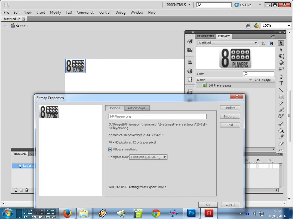

dark13 Posted December 8, 2014 Posted December 8, 2014 After importing the .png go to library, properties of .png and select "loseless" and "allow "smooth". Honestly i think it's the flash smooth to make themes looking better, hyperspin does not smooth enough pngs, it is really noticeable on text. Consider that in a 16:9 theme you will see a lot of jaggies on a 4:3 screen. I would like you to do a little test: try importing a 1080p and resizing in flash, then try a resized 1024*768 image in photoshop and import in flash (you can use the script in my sig, it converts from pngs to swf, use the one i modded to use allow smooth). Can you see any difference on a 1080p screen? I don't have a fullHD screen to test it out, on my 1360*768 screen I can't see any difference between the two methods. Automatizing infopanels creation from .csv files for HTPCs themes (look at infopanel tutorial.zip on the ftp in dark13 folder) PNGs to SWFs automatized flash scripts Hyperspin Wheelset automatized template (photoshop's variables + batch) Aeon nox 4.13 W.I.P. hyperspin skin

Styphelus Posted December 9, 2014 Posted December 9, 2014 Where's the smooth option in Flash CS6? Are you talking about the drawing settings where you select curves = smooth?
dark13 Posted December 9, 2014 Posted December 9, 2014 I'm using cs5.1 but I guess it's always there Automatizing infopanels creation from .csv files for HTPCs themes (look at infopanel tutorial.zip on the ftp in dark13 folder) PNGs to SWFs automatized flash scripts Hyperspin Wheelset automatized template (photoshop's variables + batch) Aeon nox 4.13 W.I.P. hyperspin skin
Iggy Posted December 9, 2014 Posted December 9, 2014 Where's the smooth option in Flash CS6? Are you talking about the drawing settings where you select curves = smooth? With the image you import into Flash...go under Library and expand the tree until you see your imported image....right click and go to properties and you should see it under compression....like in Dark's picture [sIGPIC][/sIGPIC]Sega Saturn Japanese Wheel Project: COMPLETE!! If you have FTP access, find my name and grab the set now!!!
Iggy Posted December 9, 2014 Posted December 9, 2014 Can you see any difference on a 1080p screen? I conducted the test and found no difference between the two methods on my screen. They look identical. Looks like Adobe might have corrected the jaggies I was seeing when resizing in Flash with one of their updates. My screen is a 1920x1200 res LCD. [sIGPIC][/sIGPIC]Sega Saturn Japanese Wheel Project: COMPLETE!! If you have FTP access, find my name and grab the set now!!!
