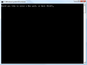

With SkipPrompts set to no, here are a couple screen shots:

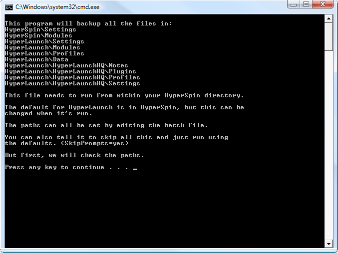

1). When run, you will see a little info on what the script will do.
2). Hit a key and it asks you to confirm your HyperLaunch directory. If you hit Y for Yes, it jumps to Step 5.

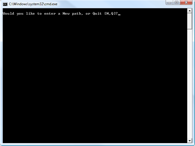

3). If you hit N for No, it asks if you would like to enter a New path to HyperLaunch or Quit.

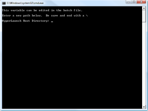

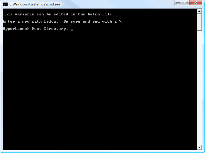

4). If you hit N for New Path, it asks you to enter the path to the HyperLaunch root directory. Once you enter it, it goes back to Step 2 to confirm.

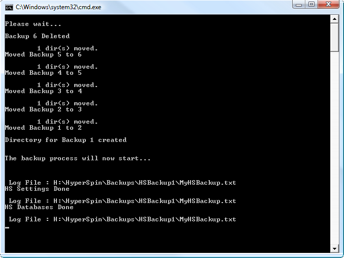

5). The script then checks your HyperSpin and HyperLaunch path to see if they exist. If so, the backup starts.

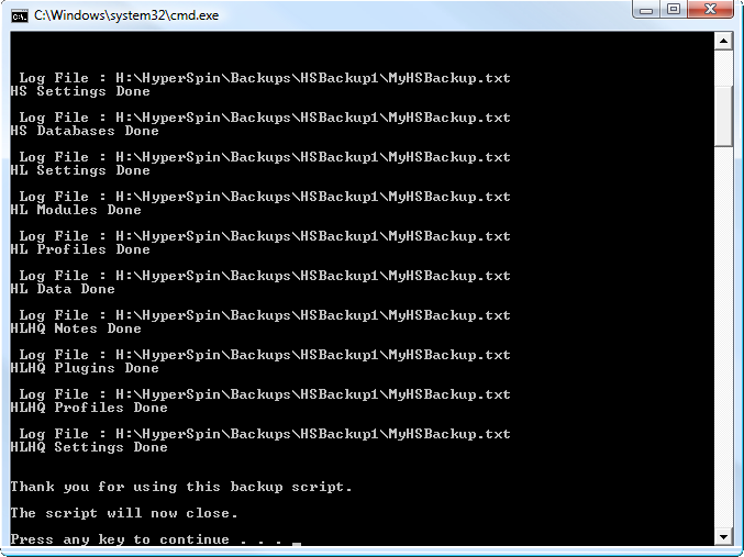

6). When finished, you get a thank you and hit any key to close.
