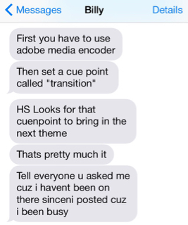

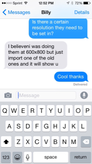

baddeolv Posted January 10, 2015 Posted January 10, 2015 I didn't get it either dark, this conversation went down in 2009 when the transitions were still a "new" addition. I honestly, couldn't give you any useful insight on the subject these days. All I remember is the after effects prerequisite, and something about exporting several different aspects. I'll give billy a call and try to get specifics. Instagram : baddeolv Facebook : Brian Addeo
baddeolv Posted January 10, 2015 Posted January 10, 2015 From the horses mouth Instagram : baddeolv Facebook : Brian Addeo
KlopjerO Posted January 10, 2015 Author Posted January 10, 2015 I'll see what I can do with this.. setting a marker and labeling it "transition" is key it seems.. Tomorrow I'm going to import my FLV in AE and add the marker ..see how that works thank you Baddeolv This has been insight full *edit* had to look it up, and I'm currently rendering the flv and firing up my vm hyperspin https://helpx.adobe.com/after-effects/using/layer-markers-composition-markers.html *edit 2* crap.. added a mark, edited it so it had a flash cue called transition, but the proper background wouldn't load. I'll have to give this more thought... | My themes / downloads | Get the MS-DOS Wheel sound pack | Get your MS-DOS game themes here | Get the MS-DOS wheel set here | My YouTube channel | WarcrafT - Lord of the clans |ZeroJay's Ultimate DooM archive
