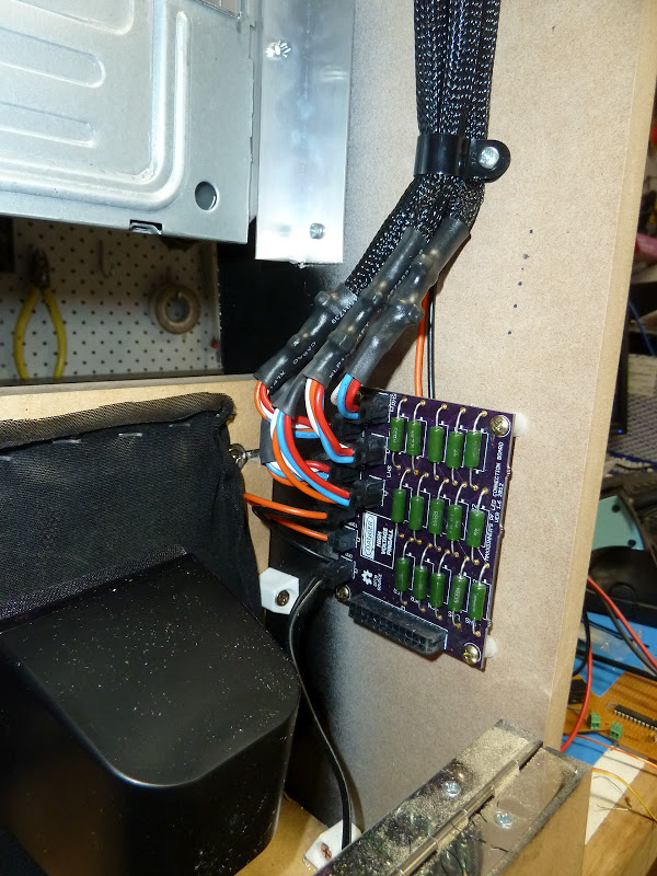

maxxsinner Posted June 25, 2012 Author Posted June 25, 2012 Thanks gents Got a little delivery today that I have been checking the mail for everyday for the last couple of weeks... My custom resistor boards ...... The one on the top left is for the playfield and the one on the bottom right is for the backbox. One of the requests my brother had for his cabinet was to make the playfield LED's adjustable. Sure you want them bright but would be nice if the eyes weren't damaged in the process. I was a bit stuck on how to do it. A resistive pot in series with each led would do it, but a PITA to adjust them all for a quickgame as you would need 15. One large variable reistor in series with the supply to adjust the common voltage would work, but one that would be big enough for the job would look like the big ceramic tube type that need a socket set and screwdriver to adjust it... Less than convenient. Then I came across these DC-DC converters. It's the little green board fitted to mine below So now I can run my Crees on the playfield at the full 700 mA if I want or with a quick turn of a reisitive pot just inside the coin door, dial up any brightness I want. The sockets I am using are a mini version of the same sockets used on ATX mother boards. As I am running this board with 5 volts that will be limited to a maximum of 3.9, the reistors can be a lot smaller. These ones are rated at 3 watts. Anyone still waiting on my coin door boards, please be paitient. There was a little mix up that is being sorted and I hope to see them very soon. Electropin - Enough lights to land a jet on an aircraft carrierHigh Voltage Pinball - Cause one build just wasn't enough Voltek Arcade - Funglo pedestal style mame cabinet Pinball Electrical Tutorial - Wire All Your Bling With Confidence and Fewer House Fires

Nemo Posted June 25, 2012 Posted June 25, 2012 Professional grade boards ! Those DC-DC converters utilise Pulse Width Modulation to control voltage ? Nice silkscreen print, like the "Danger High Voltage Pinball" logo, how cool is it having your name on those puppies ?
maxxsinner Posted June 25, 2012 Author Posted June 25, 2012 Thanks Chris and Nemo. The DC boards Nemo are a buck converter so they work a little different to PWM. Loved being able to put my logo on there Electropin - Enough lights to land a jet on an aircraft carrierHigh Voltage Pinball - Cause one build just wasn't enough Voltek Arcade - Funglo pedestal style mame cabinet Pinball Electrical Tutorial - Wire All Your Bling With Confidence and Fewer House Fires

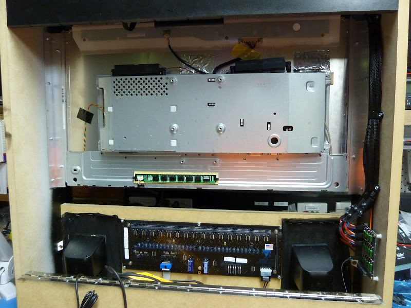

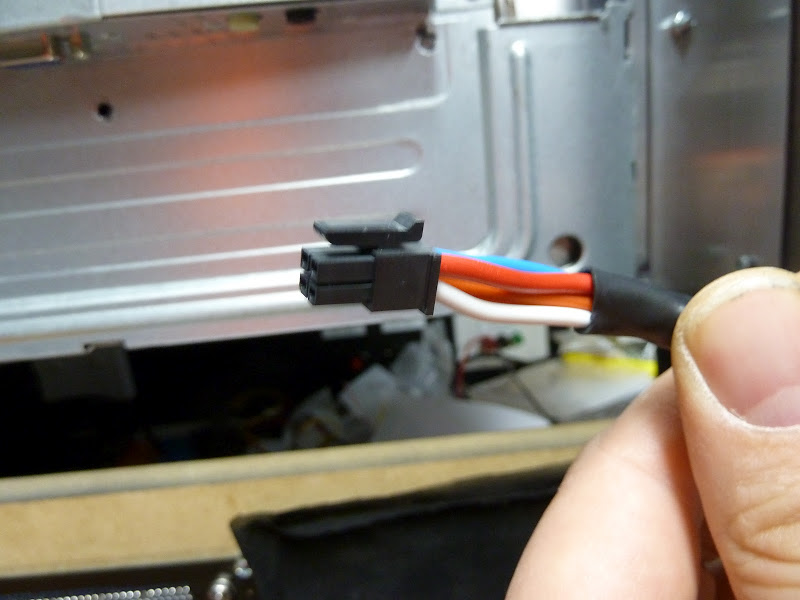

maxxsinner Posted July 1, 2012 Author Posted July 1, 2012 Got a bit done over the weekend finally. Custom plugs for the LEDs were time consuming but worth it. Mounted the resistor board and terminated all the LEDs and Strobe Crees. Mounted the DMD, speakers and monitor. Just used a couple of lengths of aluminum angle to mount the monitor. Once decased the monitor had a few threaded holes on the side that were the same thread as motherboard mounting screws (the tight thread ones from Lian li, etc). So I attached some angle onto the monitor, the same on the backbox and bolted the two together. Easy! Little bit to go on the backbox now... and have to track down a nice Williams logo to fit the spot below the DMD. Electropin - Enough lights to land a jet on an aircraft carrierHigh Voltage Pinball - Cause one build just wasn't enough Voltek Arcade - Funglo pedestal style mame cabinet Pinball Electrical Tutorial - Wire All Your Bling With Confidence and Fewer House Fires

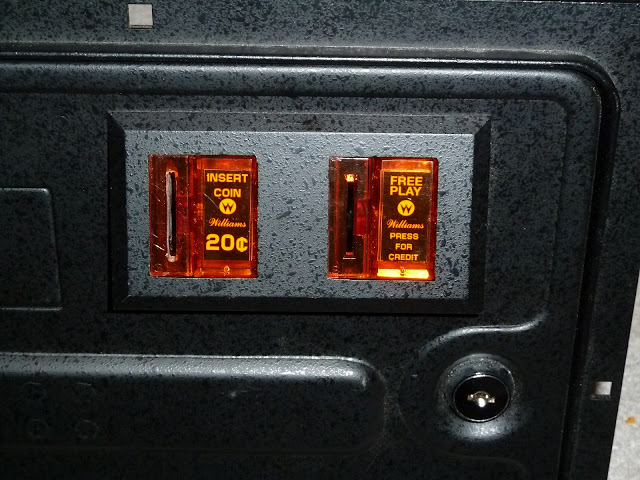

maxxsinner Posted August 1, 2012 Author Posted August 1, 2012 Cheers Josh. Work has stolen a lot of my time of late so progress has come to a slow pace... but got a few little things done. One thing that I loved about Chris's builds is his attention to detail. I really believe that seperates the good cabinets from the great ones. So stumbing around the net one night I found this forum post - http://www.dragonslairfans.com/smfor/index.php?topic=2468.0 for some nicely done 'push to reject' or 'insert coin' labels. With a little modding I came up with these And as I asked on another thread, I was dying to get hold of some old 20 cent Australian coin mechs. Found a guy on Ebay in the end that had a couple of spares laying around that he was happy to part with. Came home to a little package today 2 x 20 cent coin mechs! And they work perfect. More updates soon.... I hope Electropin - Enough lights to land a jet on an aircraft carrierHigh Voltage Pinball - Cause one build just wasn't enough Voltek Arcade - Funglo pedestal style mame cabinet Pinball Electrical Tutorial - Wire All Your Bling With Confidence and Fewer House Fires

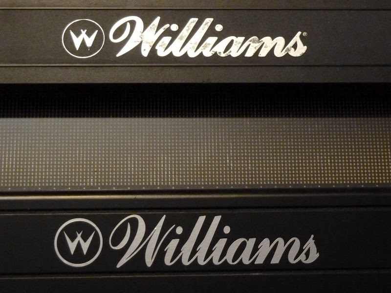

maxxsinner Posted August 3, 2012 Author Posted August 3, 2012 Thanks Zeb. Wanted a Williams logo below the DMD so had a chat to a local sign writer and took him an old WPC95 speaker panel as a reference. Here is a shot of the results. The top one is the reference speaker panel I cannot get a shot that does it justice! If anyone wants one, he is selling them for $20 each Electropin - Enough lights to land a jet on an aircraft carrierHigh Voltage Pinball - Cause one build just wasn't enough Voltek Arcade - Funglo pedestal style mame cabinet Pinball Electrical Tutorial - Wire All Your Bling With Confidence and Fewer House Fires
mameman Posted August 3, 2012 Posted August 3, 2012 Lol, I had not thought of using my vinyl cutter for those. Comes out nice. Will have to give that a try. PM me for any custom CNC needs. Find me on Facebook.. Xtreme Pinball or www.xtremepinball.com Ipad pinball cabinet iFlipper Here: See the Doctor Who build Here.... / See the Tron build Here.... / See the BattleStar Galactica build Here.... See the Big Bang Bar build Here.... / See the Twilight Zone build Here.... CNC Work Here.....
maxxsinner Posted August 3, 2012 Author Posted August 3, 2012 I am happy how they turned out MM. Sure they dont sit proud of the speaker panel like the real thing but saves a heap on getting them on laser cut steel or aluminum. Side art is all done now by Shadman. Here is the final result. Electropin - Enough lights to land a jet on an aircraft carrierHigh Voltage Pinball - Cause one build just wasn't enough Voltek Arcade - Funglo pedestal style mame cabinet Pinball Electrical Tutorial - Wire All Your Bling With Confidence and Fewer House Fires
