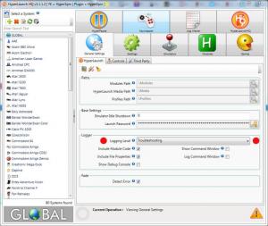

gigapig Posted January 24, 2015 Posted January 24, 2015 No, your Hyperlaunch log, not HLHQ, as they are different. Make sure it set to level 10, so in HLHQ change logging level to troubleshooting. Thanks. I also prefer nulldc.

gigapig Posted January 25, 2015 Posted January 25, 2015 i dont seem to have a hyperlaunch log anywhere Make sure it's set to troubleshooting. If you don't see the log in the your hyperlaunch folder, you may have windows explorer set to not show extensions. The file will be just named "Hyperlaunch" When posting, please include the code tags.
