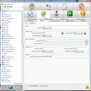

gigapig Posted February 8, 2015 Posted February 8, 2015 For Mame at least the bezel has to be on for IC's to function, marxkemp in his video has an active bezel, but the question here is for full screen IC's. There is a way around it but it may not work for all emulators as it is Emu dependent. You can have bezels set to true and not have any bezels in the folder. Bleasby has added a Full screen bezel option in HLHQ. Switch this to true and you can normally press the bezel change key to cycle through the bezels and then once all bezels have shown you eventually get the game to go full screen. Having no bezels and you will just get the game at full screen and also instruction cards. When we did the Mame Artwork Bezel Project we added a full screen transparent image to basically do the same thing; you could try that also if the above does not work. Another thing would be to ask Bleasby if it is possible to have Bezels and IC's independent of each other, if they are not already.

marxkemp Posted February 8, 2015 Posted February 8, 2015 yup. Pig is right. If I have specific game IC's it wont work as on my video. My guess is to do something with the positions options in hlhq update: Created a "IC Menu Left - Controller 01 - bottomCenter.png" file in _default with my controller image.. and hooked it up to my "L" key in HLHQ at Left Menu Key. Now i can change my IC's from street fighter 3rd strike with Z X C V keys and my general controller file shows up with L
Takaji Posted February 13, 2015 Posted February 13, 2015 I can't get this working at all. I've tried placing "IC Menu Left - Controller 01 - bottomCenter.png" in HyperLaunch\Media\Bezels\Atari 2600\_Default, have ICs enabled and bezels enabled in HLHQ, also have fullscreen bezel set to true. When I try using my keyboard shortcut to access the IC menu or a key mapped to show the left menu, nothing happens. Can someone be a little more concrete and share their config or something instead of these little snippets of what to do? Thanks guys
