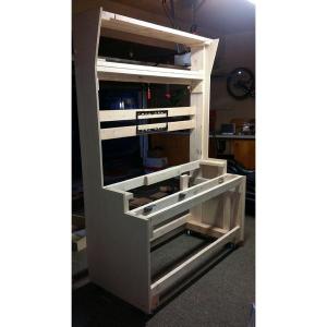

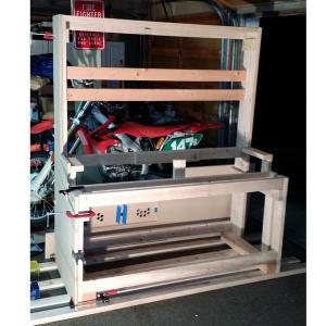

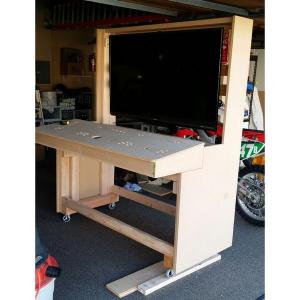

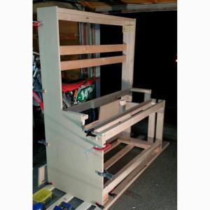

Here's the main body with the removable upper body on top. The upper body will house the ultrawide dynamic marquee monitor and speakers. I designed this cab to be modular with a removable CP and upper body so I can fit it in my house :)
The overall dimensions are 95" tall by 65.5" wide. Yes it's big
I guess as far as non-pinball cabs go, we can call this one a wide body, lol

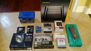

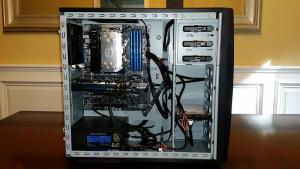

Ah the Antec 300, it hosted my previous pc, but it was just too small for my current. Good case though, even though your're hiding it away

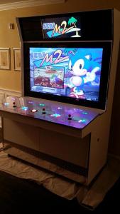

All arcade emulators, console emulators, and pc games that I can get my hands on. I will hook up my Ps4 and Xbox one also. So far I've set up many emulators on this pc and I'm real happy with the 60" tv. And yes as we all know the graphics aren't great on the old games. But having the big screen is a benefit, not a hinderence in my opinion. For example the vertical games look fantastic and big ��. And the bezels look great too. House of the dead 3 looks great!
I built the cab so that the edge of the control panel is 31" away from the screen so there is a little distance between my eyes and the tv.

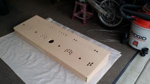

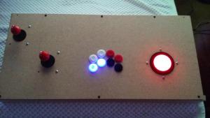

Right now I have U360's that I was planning to use for P1 & P2. They work well but I think I prefer the feel of a mechanically limited joystick with switches better. I may sell them and use servo sticks instead. If I don't use them then I can use xbox360 controllers for the emulators that need analog.
