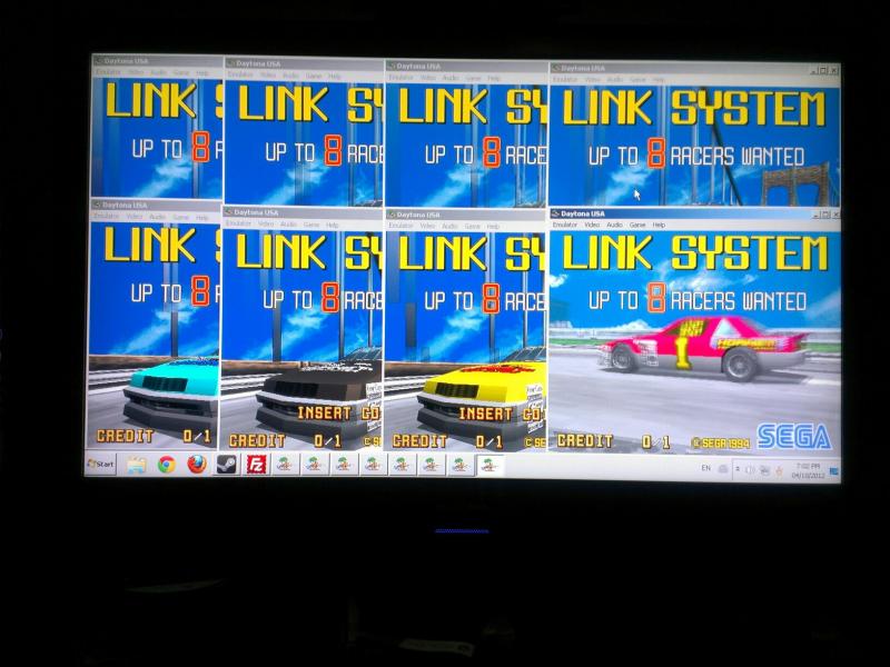

Now you can play with up to 8 people on the Sega Model 2. Imagine a Daytona race with 7 friends. Doesn't that sound awesome?
Only 4 players allowed per machine since any more looks bad on one screen and would be rough on a normal CPU.

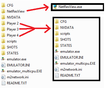

For multiplayer to work you will need to create a folder structure like the one in the image. Each folder with the red line contains the files in the black box.

; Put one installation of the emulator inside a folder named "Player 2", another installation
; in a folder named "Player 3" and finally another installation in a folder named "Player 4". These folders
; should all be inside the Sega Model 2 emulator folder.

Copy and paste the code into a .ahk file and save it.
m2network.ini
[network]
Rxport=1978
NextIp=127.0.0.1
NextPort=1979
Copy and paste the code into a .txt file and save it as "m2network.ini". Then put this file in each folder your emulator is in.

So we can now play two player with a split screen (on one actual monitor)?
- J*
How to rebuild your MAME ROM set using CLRMAMEPRO - Walkthrough HERE!
Playing on one computer would require the script to do some winmoves which will split the screen for you. Look over the script above, I'm sure it's all in there,

Yes splitscreen on one monitor is what it's supposed to do. It does splitscreen for 2,3,4,5,6,7, and 8 players. 5-8 kills my cpu and framerate though.
It does about the same thing that my module for the VBALink (Gameboy Advance) does.
I'm having trouble with it when it moves sometimes it moves and sometimes it doesn't. When it doesn't it leaves a whitespace with the window title DIEmWIN and it has the same process id. Anyone have any suggestions for fixing this?
I'm thinking about adding a gui for the individual closing out, that way you can choose which window to close instead of just closing the active one.
I also need some ideas on how a gui for linking would work. I need to take into account:
All Linking on same computer
Linking over LAN,
If linking LAN, ask for i.p. address and have the option to have a static ip address stored in an ".ini" file or in the module (static meaning no asking to type in address since it is fixed).
If linking over LAN what player number are you and splitscreen friends. (example: player 1 & 2 on computer_1 and 4 & 5 on computer_2)
Link two fullscreeens (player_1 on computer_1 and player_2 on computer_2).
I'm having the most trouble with the gui layout to make it easy to see from a distance and easy to navigate with arrow, enter and exit keys.

I have no more Daytonas left to give.
(This is on an i3 2120, 4GB RAM, GTX 560. Each game running was taking just 5% CPU time each. Everything running at a steady 60FPS in each window.)
Wow, that's one efficient emu!
