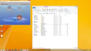

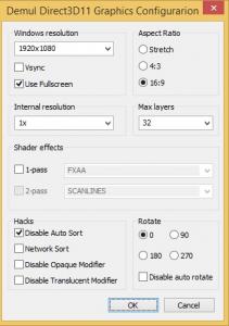

showstopper Posted February 26, 2015 Posted February 26, 2015 Hi guys, I have dreamcast working nicely with demul, with one (major) problem, I can not get it to go into full screen. Any ideas? Config --> Video --> Use Fullscreen Enabled Tried different resolutions, stretch etc it always stays windowed. Any help please? EDIT - ALT Enter just stays in fullscreen for a split second and then returns to a window. How to update HyperLaunch
rfancella Posted February 26, 2015 Posted February 26, 2015 Hi guys,I have dreamcast working nicely with demul, with one (major) problem, I can not get it to go into full screen. Any ideas? Config --> Video --> Use Fullscreen Enabled Tried different resolutions, stretch etc it always stays windowed. Any help please? Be sure you have Fullscreen set to default in the module settings if you are setting it in the emulator. If not, set it to true. Thanks, Ron Code Monkey and all around Command Line geek!If you like what someone has said or done for you, be sure and 'Thank' them. And if they changed your life, send them a Beer!
showstopper Posted February 26, 2015 Author Posted February 26, 2015 Yeah it is set to true in the module. I cant even get it to go full screen outside of HLHQ or HS. How to update HyperLaunch
rfancella Posted February 26, 2015 Posted February 26, 2015 Yeah it is set to true in the module.I cant even get it to go full screen outside of HLHQ or HS. From the module notes: ; Read the tooltip for the Fullscreen module setting in HLHQ on how to control windowed fullscreen, true fullscreen, or windowed mode; Windowed fullscreen will take effect the 2nd time you run the emu. It has to calculate your resolution on first run. Not sure if this will help or not. Thanks, Ron Code Monkey and all around Command Line geek!If you like what someone has said or done for you, be sure and 'Thank' them. And if they changed your life, send them a Beer!
showstopper Posted February 26, 2015 Author Posted February 26, 2015 From the module notes:Not sure if this will help or not. Thanks, Ron But it doesnt even run fullscreened on it's own. How to update HyperLaunch

showstopper Posted February 27, 2015 Author Posted February 27, 2015 I got it working full screen in HLHQ but the screen flickers like mad. Have installed nulldc and that works on it own but not in HLHQ! How to update HyperLaunch
vampirolatino2 Posted February 27, 2015 Posted February 27, 2015 Mmm... strange behavior ... something is preventing you for running anything fullscreen? only with Demul right? If it is, something is wrong with the emulator. Download the latest stable release. Delete all your old settings, .ini info, etc. Start fresh and just configure the emulator to run full screen, nothing more. Try that.

showstopper Posted February 27, 2015 Author Posted February 27, 2015 Thanks guys. If i run demul on its own then it refuses to go into full screen. If i do what rfancella says then it runs full screen in HLHQ but flickers like crazy. I have removed demul and installed nullDC and it now works perfectly. Reading around it looks like a dx11 plugin issue. I am running windows 8.1 which is dx12 i believe, so i guess the issue is related. How to update HyperLaunch
