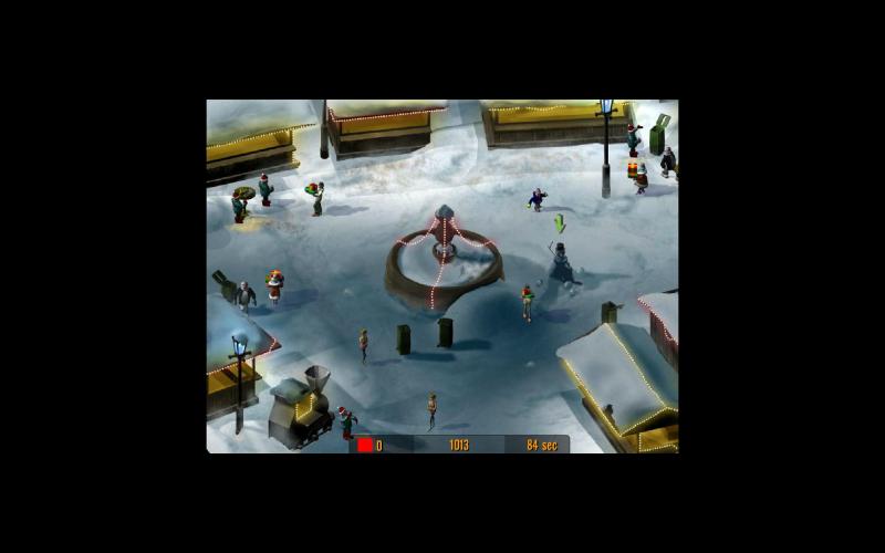

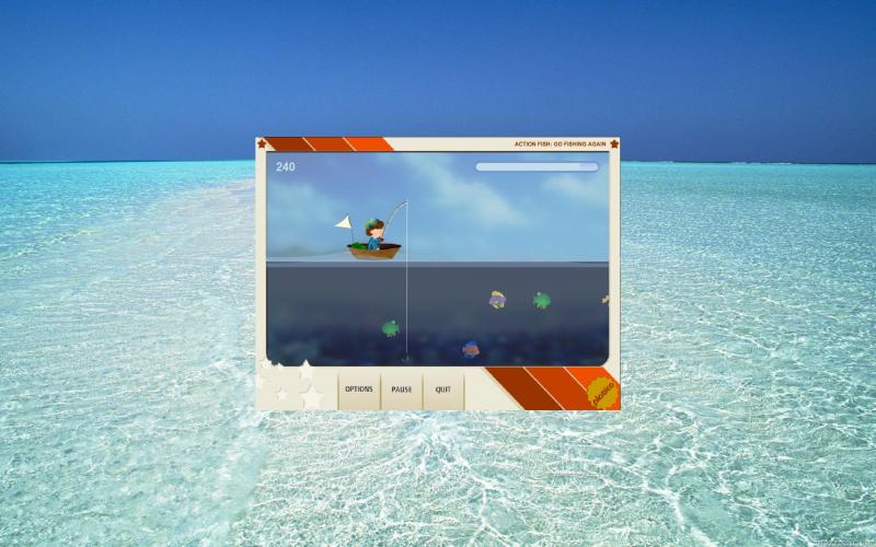

evil eye Posted October 5, 2012 Posted October 5, 2012 That's what I thought, cool! Is there a way to center a game, either in the existing app or the next version? Right now the game is defaulting to the upper left corner.
Rain Posted October 5, 2012 Author Posted October 5, 2012 That's what I thought, cool! Is there a way to center a game, either in the existing app or the next version? Right now the game is defaulting to the upper left corner. It is not possible using the current version you have; however, I did push an update which can be found here (http://www.hyperspin-fe.com/forum/downloads.php?do=file&id=5201) that allows you some extended variables for your flash games. Enjoy! Changes Added docking parameters to the settings.ini file, added height/width to the SWF loader as well as relative X/Y coordinates. Please read the settings.ini file for usage. Also, I added a command line switch that will load a game from an external flash file (if desired.) The usage for the command line switch is: flasher.exe -"c:\my path\to\gaming\my flash game.swf" Please note: You have to wrap the path in quotes if wanting to load a file from a directory with spaces in the name. Hopefully, it won't be long before an AHK file is written for this emulator (I suspect it will be very easy given that this program was designed for use with HyperSpin.) Random Screenshot Me playing one of my favorite flash games Jingle Balls. Love it cause I get to be a real bastard!
