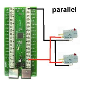

zauche Posted November 9, 2012 Posted November 9, 2012 Why don't you just connect them parallel to buttons on your control panel ? The IPAC 2 also allows button combinations: for example: hold the "player 1 start" button and press "player 2 start" to exit, ... and so on. You could also use button combinations for inserting coins if you want. I think I will connect the pinball button as the insert coin button, because I do not want to have them on my control panel. Just the 2 joysticks, 6 (or 7 - Neo Geo) buttons per player and the 1 & 2 Player start buttons. Load and Save buttons below the control panel.

zauche Posted November 10, 2012 Posted November 10, 2012 You can connect the flipper buttons parallel to other buttons doesnt matter if insert coin or others. All the sockets are the same - except the ground socket. You can connect as much buttons as you want this way, but they all do the same thing ... in this picture inserting coins. Save/Load is for other consoles, not for MAME. Hope that picture helps.
