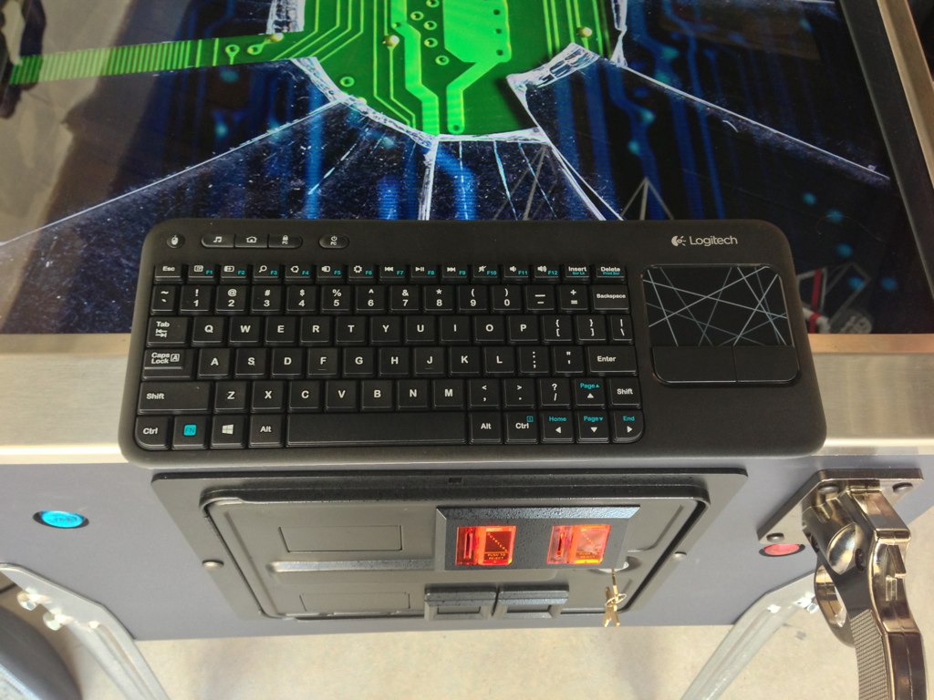

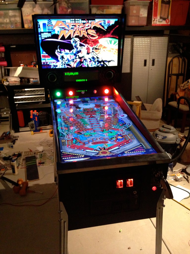

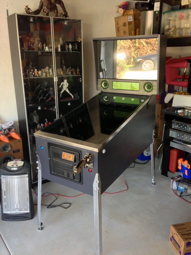

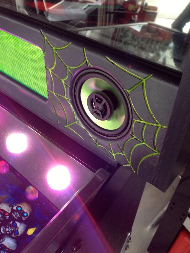

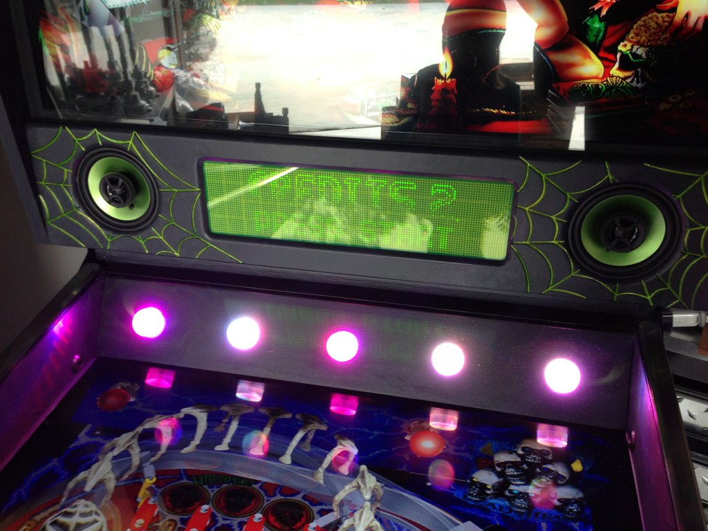

Aurich Posted February 11, 2013 Author Posted February 11, 2013 Still need to properly document, but snapped a few phone shots today: Detail of the speaker panel, really pleased with how Mameman CNC'd my spiderweb design: and both sides: Full cab shot: and finally, this little Logitech keyboard rules, it's wireless, compact, and has a built in touchpad. Perfect for easy admin of stuff. Edit: You may notice no strobes on my flasher bar. I mounted them under the cab, in the front, facing down. So now the floor lights up under you when they fire off. I much prefer this, they were just too damn bright aimed at my eyes. Has a nice immersive effect now.
technohat Posted February 11, 2013 Posted February 11, 2013 Still need to properly document, but snapped a few phone shots today:Detail of the speaker panel, really pleased with how Mameman CNC'd my spiderweb design: NICE! That looks really slick. I take it you're not planning on putting a speaker cover/grill over the speakers then?
Aurich Posted February 12, 2013 Author Posted February 12, 2013 nice BM in the reflection there Haha, you of course would spot that.
Aurich Posted February 12, 2013 Author Posted February 12, 2013 NICE! That looks really slick. I take it you're not planning on putting a speaker cover/grill over the speakers then? Yeah, no, this was designed to not have grills, the inside of the panel is routed out to get the speakers poking out, the tweeter extends past the front of the panel. Obviously in a commercial setting you need the grills to keep people from poking your speaker cones, but pretty sure I can trust my friends to not go there. I should snap a pic of the back, because the panel is routed out like that there wasn't enough MDF to actually sink screws into to mount the speakers. So I rigged a system of metal brackets and zip ties that keep the speakers firmly in place without using the normal screw mounts.
