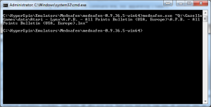

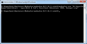

lynxboot.img is in the firmware folder and mednafen launches games from the command line fine without unzipping the roms. Mednafen version is 0.9.36.5. Module version is 2.0.9. TurboGrafx 16 is setup to use Mednafen and works fine through HyperLaunch.
As you can see, I get the same error in the log file. But mine works. Is that all you have in your stdout.txt file??
Yes.
Here's the HyperLaunch log file

I thought I'd tried launching directly from the command line, but apparently I hadn't.
Starting Mednafen 0.9.36.5
Build information:
  Compiled with gcc 4.7.3
  Compiled against zlib 1.2.8, running with zlib 1.2.8
  Compiled against SDL 1.2.15, running with SDL 1.2.15
  Running with libsndfile-1.0.25
  Compiled against libcdio 0.92 x86_64-unknown-linux-gnu, running with libcdio 0.92 x86_64-unknown-linux-gnu
Base directory: C:\HyperSpin\Emulators\Mednafen\mednafen-0.9.36.5-win64
Internal emulation modules: nes snes gb gba pce pce_fast lynx md pcfx ngp psx vb wswan sms gg cdplay demo
External emulation modules:
Loading settings from "C:\HyperSpin\Emulators\Mednafen\mednafen-0.9.36.5-win64\mednafen-09x.cfg"...
Initializing joysticks...
 Joystick 0 - XInput Unknown Controller - Unique ID: 0000000000010000
Loading Q:\GazelleGames\data\Atari - Lynx\Bill & Ted's Excellent Adventure (USA, Europe).zip...
 Applying IPS file "Q:\GazelleGames\data\Atari - Lynx\Bill & Ted's Excellent Adventure (USA, Europe).zip.ips"...
  Failed: Error opening file "Q:\GazelleGames\data\Atari - Lynx\Bill & Ted's Excellent Adventure (USA, Europe).zip.ips": No such file or directory
Unrecognized file format.
and again trying to use a decompressed .lnx file
Build information:
Loading Q:\GazelleGames\data\Atari - Lynx\A.P.B. - All Points Bulletin (USA, Europe)\A.P.B. - All Points Bulletin (USA, Europe).lnx...
 Applying IPS file "Q:\GazelleGames\data\Atari - Lynx\A.P.B. - All Points Bulletin (USA, Europe)\A.P.B. - All Points Bulletin (USA, Europe).lnx.ips"...
  Failed: Error opening file "Q:\GazelleGames\data\Atari - Lynx\A.P.B. - All Points Bulletin (USA, Europe)\A.P.B. - All Points Bulletin (USA, Europe).lnx.ips": No such file or directory
