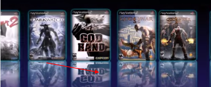

Undertow76 Posted April 28, 2015 Posted April 28, 2015 How do you make a reflective surface when creating a theme, I want to make the floors reflective. I really want the box art to reflect on the floor, how would I go about that in gimp? Is there like a batch file or easy way to do this? here's an example of what I want to do.
dark13 Posted April 28, 2015 Posted April 28, 2015 I don't use GIMP, in photoshop you can record an action while creating reflection on one boxarts then launch that action on all boxarts. Automatizing infopanels creation from .csv files for HTPCs themes (look at infopanel tutorial.zip on the ftp in dark13 folder) PNGs to SWFs automatized flash scripts Hyperspin Wheelset automatized template (photoshop's variables + batch) Aeon nox 4.13 W.I.P. hyperspin skin
JayC Posted April 29, 2015 Posted April 29, 2015 I'd say duplicate the layer and flip it and move it down...make it lighter and reduce the contrast. Maby use a gradient mask to make it fade out at the bottom. I think the example in your post has a blue tint on it as well as a blue glow around both the box and the reflection. (Best to put the glow before you fade it out!) And like dark said...in Photoshop you can record it as a action that you then can use to batch process the lot.
