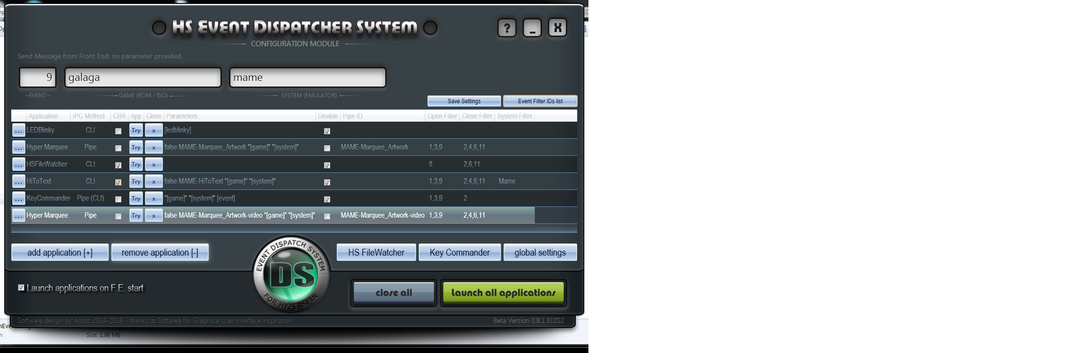

Reefboi16 Posted September 4, 2017 Posted September 4, 2017 Hey @sevenseal is it still recommended we use PIPE only for IPC Method? Because it is not working on any of the Hyper Marquee applications I have added.
Antos Posted September 4, 2017 Author Posted September 4, 2017 6 hours ago, Reefboi16 said: Hey @sevenseal is it still recommended we use PIPE only for IPC Method? Because it is not working on any of the Hyper Marquee applications I have added. (Pipe) or (Pipe-cli) is best for HyperMarquee. It is probably a small omission on your side. Sevenseal or I can help you. We will need more info to troubleshoot. For now try this Parameter format for HM: false config_File_Name "[game]" "[system]" "" [event] Let me know. HyperMarquee & Event Dispatch System
sevenseal Posted September 4, 2017 Posted September 4, 2017 Hey [mention=19166]sevenseal[/mention] is it still recommended we use PIPE only for IPC Method? Because it is not working on any of the Hyper Marquee applications I have added. follow out what antos had mention, thanks antosSent from my SM-G928V using Tapatalk
sevenseal Posted September 5, 2017 Posted September 5, 2017 Hey [mention=19166]sevenseal[/mention] is it still recommended we use PIPE only for IPC Method? Because it is not working on any of the Hyper Marquee applications I have added. best to stick with pipe(cli)just so you know pipe alone can not open apps, pipe can only send parameters... so when a app is close; it is sending parameters to a app not running.cli can open an app that is not running.... thats why we encourage to use pipe(cli)Sent from my SM-G928V using Tapatalk
