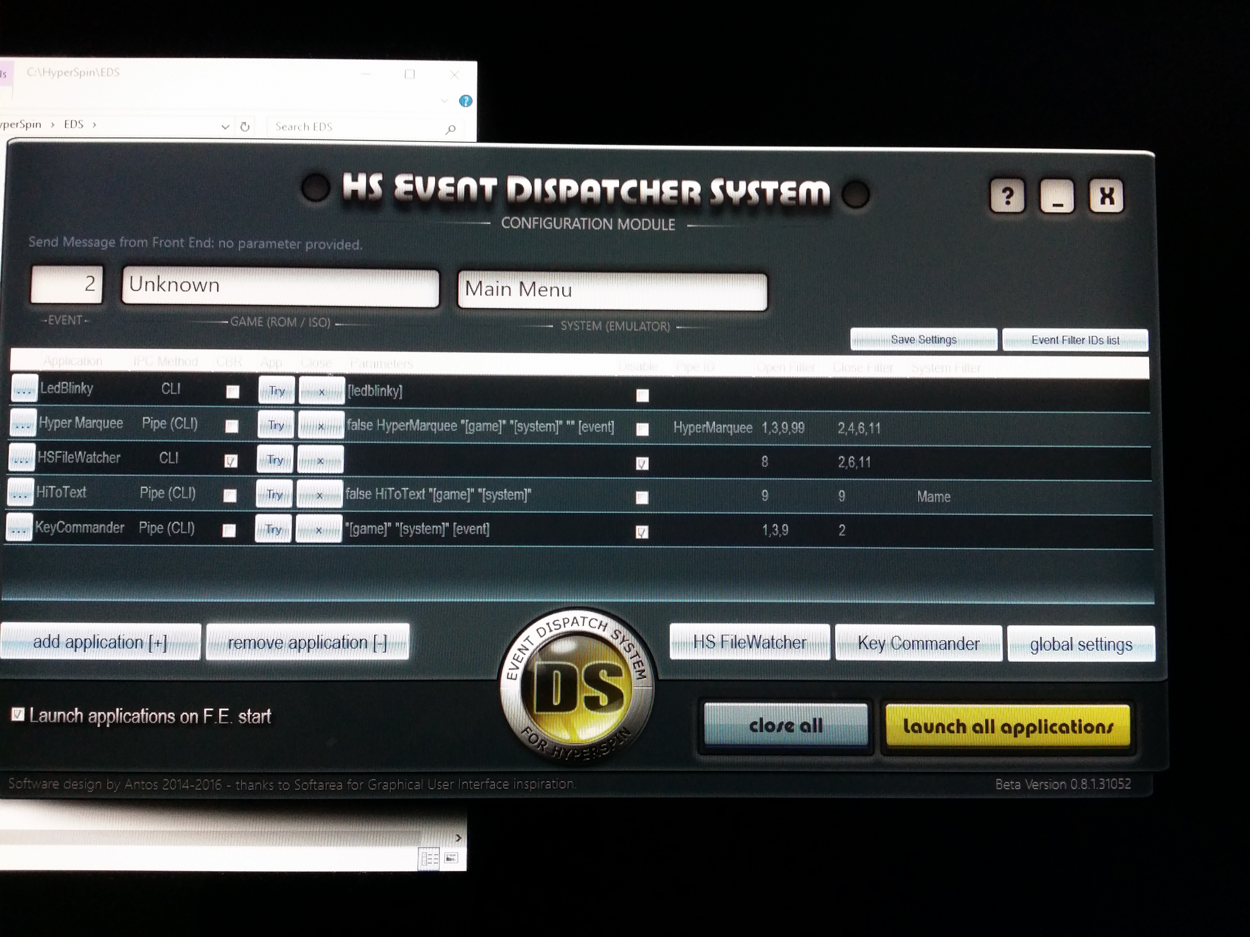

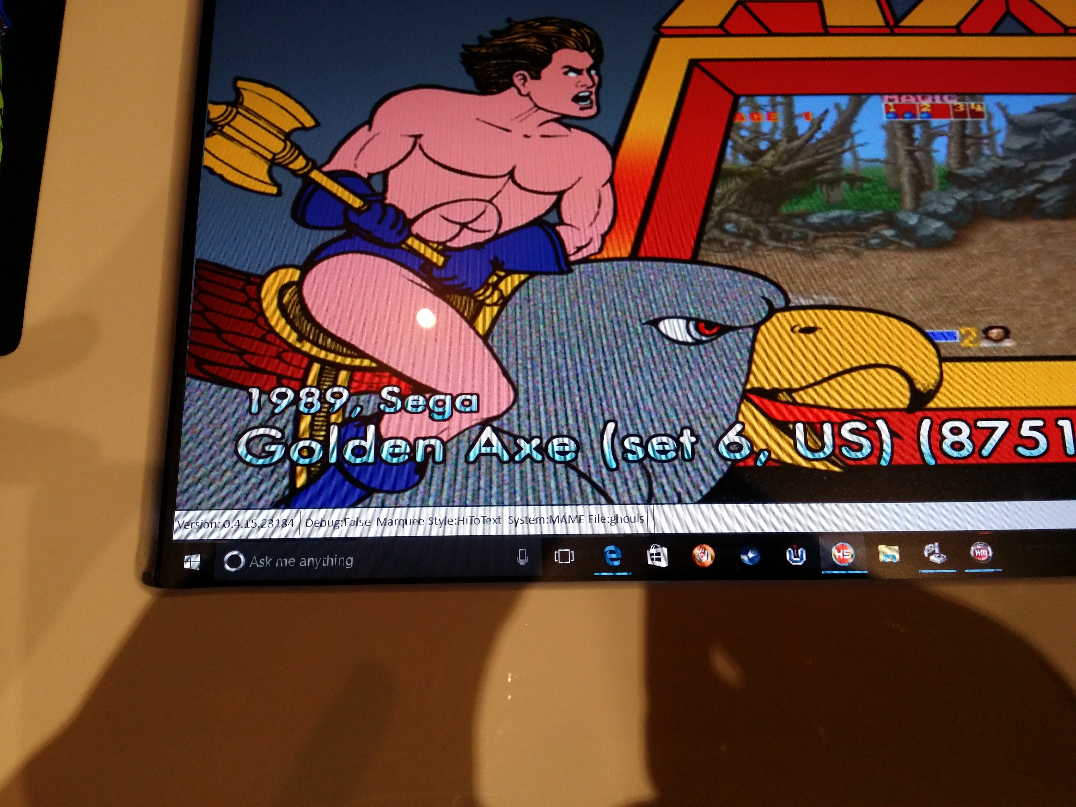

gigapig Posted November 14, 2016 Posted November 14, 2016 I have a couple of questions regarding EDS. First one is about this screen shot of my cab showing the Hiscore window, notice the text along the bottom. An idea why that may appear, the hypermaquee woindow for the hiscore is full screen. My other question is about having EDS launch JoyToKey so I can remove it from the startup in HyperHQ. Has someone got a little guide or settings they have used. I've only just started using JoyToKey so still messing with it. Thank you in advance and many thanks to Antos and Sevenseal for their work on this, it really has made my unusual cab look pretty rad and make me smile.

gigapig Posted January 3, 2017 Posted January 3, 2017 20 hours ago, Antos said: Oh no, lol!! No worries, we will help you. Just find a time with Sevenseal or me. If you still have your EDS setting config file, it will be easy to put things on track. Antos, Thank you Antos, I think I've been able to fix it. On my cab the EDS_Settings.config was blank so I copied the one from my main PC and the GUI was then able to start. All is back to normal and hopefully the settings in the screen shot are correct, just need to figure out Hyperspeech.
sevenseal Posted January 3, 2017 Posted January 3, 2017 Thank you Antos, I think I've been able to fix it. On my cab the EDS_Settings.config was blank so I copied the one from my main PC and the GUI was then able to start. All is back to normal and hopefully the settings in the screen shot are correct, just need to figure out Hyperspeech. to add hyperspeech---- just add hyperspeechproxy as an app then set as cli parameter is [ledblinky] pid is blank open filter is blank close filter blank system filter blank NOTE: in hyperspeech.ini set true ledblinky to false

gigapig Posted January 3, 2017 Posted January 3, 2017 2 hours ago, sevenseal said: to add hyperspeech---- just add hyperspeechproxy as an app then set as cli parameter is [ledblinky] pid is blank open filter is blank close filter blank system filter blank NOTE: in hyperspeech.ini set true ledblinky to false Thank you gentlemen. I have these settings in EDS and I am setting the path to the ledblinky in the Hyperspeech folder. The speech is working but not fully, system names and bios are still not working and neither is the greeting. I was under the impression that this was fixed in version 0.81 of EDS.
