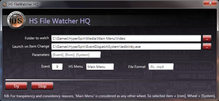

Antos Posted September 29, 2014 Author Posted September 29, 2014 NEWS UPDATE - 2014/09/28 EDS (Beta Release version 0.6.7) is now available for download. This is an evaluation version for beta testers only. Improvements - New EDS module HS File Watcher! Now trigger Event on HS 'Main Menu' using HSfileWatcher. (Initial beta release for testers - please read installation & configuration instructions) - Add remove item button - System filter: Within the textbox, give the possibility to exclude systems and let all others. use exclamation mark (!,) in front of the list. Example: "!, Daphne, Mame" means all system goes excepted Daphne & Mame - Minor bug fixes (CBR - now prevent closing when parameter event is not part of open EventFilter list - will close before re-run only if event is part of event list) - Special thanks to brolly, gooch and ghutch92 for their precious support on HSfileWatcher! And to support my impatience sometimes, I had to put aside other projects for this one. Hoping it will be stable the first time.. [ATTACH=CONFIG]45246[/ATTACH] ***************************************************************** HS File Watcher - Beta Version 0.1.0 release - 2014-09-28 A. Installation 1. Download new EDS version 0.6.7: http://1drv.ms/1yxhSDv 2. Download HS File Watcher: http://1drv.ms/1yxhSDv 3. Download Handle 4.0: http://technet.microsoft.com/en-us/sysinternals/bb896655.aspx 4. Copy HSFileWatcher folder inside Event Dispatch System (EDS) - or somewhere else. 5. Copy Handle.exe into HSFileWatcher folder 6. Launch and configure HSFileWatcherHQ.exe B. Configure HSFileWatcher inside Event Dispatch System (EDS) 1. Recommended to use EDS 0.6.7 and up. 2. Add HSFileWatcher - IPC Method: CLI - CBR: Checked - Event Filter: 8 - Close Filter: 2,6,11 3. Try it to remove Handle.exe disclaimer. (one time) ****************************************************************** NB: Using 'HS File Watcher' with EDS may not be intuitive the first time. Please follow the instructions. I tested it on 2 PCs, it worked pretty well so far at home (Win7 & Win8). - 'HS File Watcher' role within EDS: Call EDS to launch other third party apps on Main Menu event using open Video. This is a hack, HyperSpin do not support Main Menu events like other Wheels. - I may provide a use case if users feel that it is to abstract within EDS. LMK. HyperMarquee & Event Dispatch System
Antos Posted October 2, 2014 Author Posted October 2, 2014 NEWS UPDATE - 2014/10/02 - HS File Watcher (EDS module - Beta Release version 0.1.1) is now available for download. This is an evaluation version for beta testers only. Improvements - User can now edit the File Format field. - User can now edit/customize the third-party parameter field. - 'Folder To Watch' have been removed. HSMenu have the same purpose and does the same job. - Some internal code improvements (but no bug have been reported from the previous version). - Special thanks to brolly, gooch and ghutch92 for their precious support! ***************************************************************** HS File Watcher - Beta Version 0.1.1 release - 2014-10-02 A. Installation 1. Download new EDS version 0.6.7: http://1drv.ms/1yxhSDv 2. Download HS File Watcher: http://1drv.ms/1yxhSDv 3. Download Handle 4.0: http://technet.microsoft.com/en-us/s.../bb896655.aspx 4. Copy HSFileWatcher folder inside Event Dispatch System (EDS) - or somewhere else. 5. Copy Handle.exe into HSFileWatcher folder 6. Launch and configure HSFileWatcherHQ.exe B. Configure HSFileWatcher inside Event Dispatch System (EDS) 1. Recommended to use EDS 0.6.7 and up. 2. Add HSFileWatcher and use this recommended configuration within EDS. - IPC Method: CLI - CBR: Checked - Event Filter: 8 - Close Filter: 2,6,11 3. Try it to remove Handle.exe disclaimer. (one time) ****************************************************************** Hope you will like it. HyperMarquee & Event Dispatch System

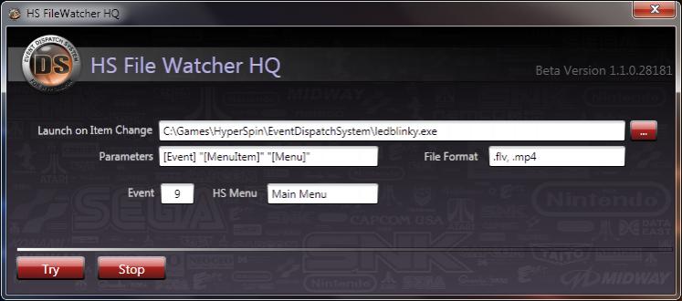

sevenseal Posted October 3, 2014 Posted October 3, 2014 on 0.1.0 it work fine, but 0.1.1 the main menu marquee are not being triggered as well as 0.1.0 when hovering over the main menu selection; on 0.1.1 the marquee only changes probably ever 6 or 7 movement on a selection, I know the event is trigger by the mp4 or flv are loaded by hypersin just to inform you that I am aware of that. eds is on default with each programs set to their directory. hsfw is on default except for directory is set where eds's ledblinky.exe is set at Hm is set to default with plain wheel images
Antos Posted October 3, 2014 Author Posted October 3, 2014 on 0.1.0 it work fine, but 0.1.1 the main menu marquee are not being triggered as well as 0.1.0 when hovering over the main menu selection; on 0.1.1 the marquee only changes probably ever 6 or 7 movement on a selection, I know the event is trigger by the mp4 or flv are loaded by hypersin just to inform you that I am aware of that. eds is on default with each programs set to their directory. hsfw is on default except for directory is set where eds's ledblinky.exe is set at Hm is set to default with plain wheel images Thanks for testing HSFW. I did some tests with the 0.1.1 version and I can't reproduce the error at home as yet. Everything works as supposed. I am trying to think what can cause that and I can't find anything so far. I can send you the code if you like and you can make some home debugging tests trace. (if you are a coder ) The application is developed using .net WPF/c# 2013 Else, we can still work together until we find the problem/solution. Did you have a look at the log file? All errors should be included in that file. Is there any other users who has encountered this problem with the new version? thanks again! HyperMarquee & Event Dispatch System
sevenseal Posted October 4, 2014 Posted October 4, 2014 logs look fine on both 0.1.0 and 0.1.1; no errors listed 0.1.0 in action... with no issue 0.1.1 in action... you will see the delay in change these are both fresh setup with only directories changes made. yes I am a coder. I could take a look at it, refreshing myself would spark the brain greatly, willing to offer any help I can
Antos Posted October 4, 2014 Author Posted October 4, 2014 Hello, I recommend to users to avoid version 0.1.1 for now. Please use HS File Watcher - Beta Version 0.1.0 until version 0.1.2. is ready. Thanks. HyperMarquee & Event Dispatch System
